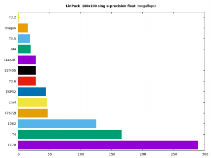

@ PaulStoffregen: Have there been any new developments regarding the RT1170 based Teensy? (Like any decisive decisions about board layout, optional memory footprints, ...)
MIMXRT1170-EVK i'll update this post as additional tests are performed ... 1170 benchmarks
Just received my MIMXRT1170-EVK board from mouser ($208). Using NXP MCUXpresso and NXP SDK, I have run a few of the examples on both cores, cm7 (M7@1 GHz) and cm4 (M4@400MHz). Peripheral IO (includes fast GPIO, XBAR, daisy) and timers (GPT 6, PIT 2x4, quad 4x4, flex PWM 4x8) look a lot like T4. I haven't figured out multicore usage yet.
  NXP 1170 memory
    512 Mbit SDRAM memory
    512 Mbit Octal Flash
    128 Mbit QSPI Flash
    2 Gbit   Raw NAND Flash
    64 Mbit  LPSPI Flash
cm7           location    size
BOARD_FLASH   0x30000000 0x1000000
SRAM_DTC_cm7  0x20000000 0x40000
SRAM_ITC_cm7  0x0        0x40000
SRAM_OC1      0x20240000 0x80000
SRAM_OC2      0x202c0000 0x40000
NCACHE_REGION 0x20300000 0x40000
SRAM_OC_ECC1  0x20340000 0x10000
SRAM_OC_ECC2  0x20350000 0x10000
BOARD_SDRAM   0x80000000 0x4000000
cm4
BOARD_FLASH      0x8000000  0x1000000
OCRAM_DTCM_ALIAS 0x20220000 0x20000
SRAM_ITC_cm4     0x1ffe0000 0x20000
SRAM_OC1         0x20240000 0x40000
NCACHE_REGION    0x20280000 0x40000
SRAM_OC2         0x202c0000 0x80000
 cm7 stack 2003ff58  ext 200014b8  const 3000a21c  fcn 30003fe1 malloc 200015f0
 cm4 stack 2023ff50  ext 2022a748  const 20227fd8  fcn 20221d49 malloc 2022a880
[B]coremark[/B] gcc 9.3.1 -O3
cm7@996 4073 iterations/sec   275 ma
cm4@400  728 iterations/sec
  Datasheet power set points
                         MHz
        set point   cm7      cm4   DCDC_IN(ma)
          1         996      400    132.4
          0         700      240     79.3
          5         240      120     42.2
          7         200      100     19.7
          9           0      100     11.8
         11           0      200     24.2
Other MCU coremark results at end of perf.txt.
Old dhrystone.c v2.1
     Dhrystone 2.1 (DMIPS)
  1170@996mhz      2277   SDK -O3
  T4@600mhz        2175   gcc -O3
  M7@600mhz        2033   ARM CC -O3
  T3.6@256mhz      1120   Fastest+pure+LTO
  T3.6@180mhz       287   Faster
  T3.6@120mhz       191   Faster
  T3.5@120mhz       138   Faster
  T3.2@120mhz       106   Faster
  ESP32@240mhz      255   -O2
  adaM4F@120mhz     168   -O2  SAMD51
  STM32L4@80mhz      63
  STM32F405@168mhz  198   -O2
  F767ZI@216mhz     773   -O3
  F446RE@180mhz     351  -O3
  pico@125mhz        20
  maple@72mhz        48
  DUE@84mhz          49
  ZERO@48mhz         24
  UNO@16mhz           6

float/double linear algebra
Linpack 100x100 mflops
               double    float
  1170@996mhz  120.3     289     NXP SDK -O3  10/19/21
   cm4@400mhz    2.7      46.2   NXP SDK -O3
  T4@600mhz     71.4     166.3   gcc -O3
  M7@600mhz     66.97    125.5   ARM CC -O3
  T3.6@256mhz    2.85     41.1   Fastest
  T3.6@180mhz    2.13     28.4   Faster
  T3.5@120mhz    0.88     19.2   Faster
  T3.2@120mhz    0.65      1.0   Faster  no FPU
  ESP32@240mhz   2.8      44.5
  adaM4F@120mhz  1.4      20.1   SAMD51
  STM32L4@80mhz  0.88     15.4   dragonfly -O2
  STM32F405@168  1.8      28.3   -O2 adafruit
  F767ZI@216mhz 24.1      47.5   ARM CC -O3
