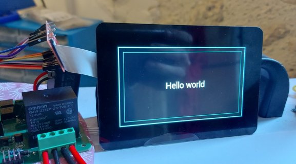

So, Let me show you the details :
Here is the situation where everything is ok :
C++:
    delay(100);
    D_LOGLN("*** Entering Setup Sequence ***")
    // Configure Pinmode
        // Digital Outputs
    pinMode(FT813_CS_PIN,     OUTPUT);
    pinMode(FT813_PD_PIN,     OUTPUT);
    pinMode(FT813_INT_PIN,     INPUT);
    digitalWrite(FT813_PD_PIN, HIGH);
    digitalWrite(FT813_INT_PIN, HIGH);
    // Init SPI
    SPI.begin();
    // Init Display
    initUi();
// Copy/pasted from example file
void initUi()
    GD.begin();
    GD.ClearColorRGB(0,0,0);
    GD.Clear();
    GD.cmd_text(GD.w/2, GD.h/2, 30, OPT_CENTER, "Hello world");
    // Added my owm rect.
    GD.Rect_Empty(
        16, 16,
        GD.w-32, GD.h-32,
        UI_COLOR_3
    GD.Begin(LINES);
    GD.ColorRGB(UI_COLOR_1);
    GD.Vertex2f(0*16, 0*16);
    GD.Vertex2f((GD.w)*16, 0*16);  //Superior
    GD.Vertex2f(0*16, (GD.h-1)*16);
    GD.Vertex2f((GD.w)*16, (GD.h-1)*16); //inferior
    GD.Vertex2f(0*16, (GD.h-1)*16); //izquierda
    GD.Vertex2f((GD.w-1)*16, 0*16);
    GD.Vertex2f((GD.w-1)*16, (GD.h-1)*16); //derecha
    GD.swap();
Here is the result : So far everything is fine.

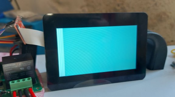

But here is the problem when I call something from the loop.
C++:

void drawTest()
    GD.ClearColorRGB(0x000055);
      GD.Clear();
      GD.finish();
      GD.SaveContext();
    GD.cmd_text(16, 16, 22, OPT_CENTER, "Test");
    GD.RestoreContext();
    GD.swap();
The "HelloWorld" screen is still showing fine, but as soon as drawTest() is called here is what i get :
This kind of "tearing" made me think of a timing issue.. But 'im really not sure.. As I manage to have a first screen looking fine, It make me confuse..
Maybe i'm just dumb and I don't understand how the lib is working ?...
If someone can land some help, I'll be very very happy !
Btw, @TFTLCDCyg, I think i've read on the forum that you are involved in the lib maintenance.. If i can help by adding support for this display, or something, i'll be glad too !
Thank you all in advance for you help !!
That 4.3" 4D Systems FT813 TFT is very good. Congratulations.
The timing table is on page 25 of the link you provided. It seems to me that the GDSTx values are compatible with those of your TFT. However, there may be two parameters that need fine-tuning, as long as you see any kind of artifact or RGB color glitches. It's already a big step that it works and responds to the GDSTx library.
These types of displays (FT80x, FT81x, or BT8xx) don't work like typical SPI displays: ILI9341, ST7735, ILI9488, etc. On all of them, the previous display screen must be cleared before the next one can be displayed.
It's actually a graphics chip that works with a 60 Hz refresh rate, so it's not necessary to clear what's displayed on the TFT every time a primitive is updated or a new one is loaded. Presentation.
Based on this approach, it's not necessary to use the delay instruction or constantly clear the screen; programming is simpler.

Try the sketch. If it doesn't work, it seems to me that, like the Riverdi BT817 TFT, the 4Dsystems TFTs require a software reset via the PD pin. GDTSx manages this via pin 24 of the Teensy 4.1. For this, we could define a specific SizeEVE constructor, perhaps called 432, which is only for the 4DSystems 4.3"/FT813 display.

So ! I've tried your two sketches, and there is progress !! I'm still using the "SizeEVE=43", and the gradient screen (with "Hello World" and various info and properties) is showing fine ! (See attached Files)
So, I guess you're right, I have to just call some kind of an "update()" / "refresh()" function in the loop directly. If i put a delay between the calls in anyways, nothing works, and I get a "tearing" display again.
So now, the only problem that persist is that the text shown is flickering... I assume every time the function is called ?.. maybe a bit slower !
So, it's already a lot better ! But there is still this little issue.. And I don't what causes this...
I also see a little "gap" at the bottom right of the screen, and i don't know if it's just some "hardware" particularity or if it's the symptom of a configuration problem.
See :

Okay ! So, I found the problem !!
Just to recap : I've tested and tweaked the timing setting, but it was just the same... the screen was still flickering.
So, I got the intuition that I should do something wrong...
And I was right that I was wrong ! (Sorry for that pun..)
So, like I was saying, I'm working on a larger project, and over displaying information, I have to perform some computing and regulations...

Because this approche didn't freeze the loop, I thought at first that it didn't interact with the display... but.. It does 😅
The timer is "timeout" every 100ms (10Hz).. and the screen was flickering at... 10Hz !
I've tried to change the timer period, and it directly change the flickering speed..
And the flickering completely stopped if I commented the "processing" section.
So, good news : everything is fine with the lib and the display !!
Bad news : I'm dumb ! And I should have shared the full code, and think about this issue sooner 😅
