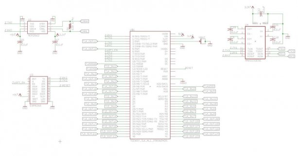

I'm designing a generic board to use in my cars (or other projects) that the inputs/outputs of the Teensy will be protected.
Just want to make sure I haven't over looked things, or have the resisters on the correct side.
Teensy 3.6
ESP8266 Wifi, CAN, and RS232

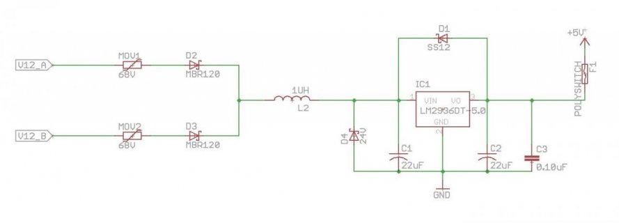

Power
Have two power sources incase of failure. Or from different sources (Key ON vs Key ACC)

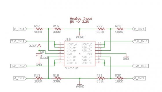

Analog in
Most of the car sensors are 5V. Using the MCP6404 and voltage divider seems to be the safest way to bring values down to 3.3V

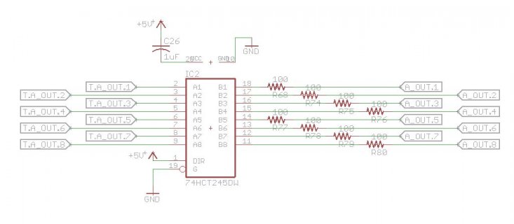

Analog out (PWM)
I read the 74HCT245 is good for PWM speeds. This will drive LED or Servo's.

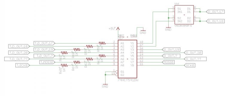

Digital out
Some will be able to sink a Relay, while others are just 5V for Led, SPI, etc. 1K resister on the teensy side ok ?

I think I'm safe to remove the resistors between the teensy and 74HCT IC on Digital out, it's not necessary. Would I need anything on the MOSI output side for protection?
I see the OctoWS2811 uses 74HCT245 (bus transceiver), but I also looked at the 74HCT541 (buffer) instead. I don't really see much difference between them, other then a nano second here and there in specs.

Here's my final draft in Eagle. Let me know what you guys think. Schematic only, going to start on board design.
16 - digital out (-)
12 - digital in (-)
14 - analog out pwm
8 - analog in (5v)
2 - serial bus
2 - power inputs
1 - spi out
1 - can bus
1 - wifi
