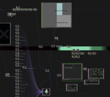

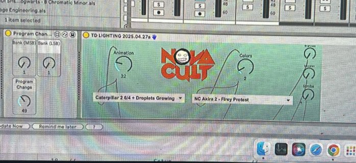

END GOAL:
Replace the Arduino Uno R3 in my LED setup with the Teensy 4.1 to extend my working 40pixels per strip (6 strips total) to be able to handle 140 pixels per strip.
THE LAST BEST STATE:

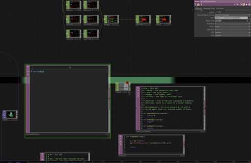

I was able to send GRB values from Touchdesigner to my Arduino Uno R3 and successfully get 6 strips to light up 40 of their 140 pixels to produce my TD animations over Serial at an 115200 baud rate. As I'd increase the pixel count per strip, that's when the animation would glitch and show the wrong colors more and more out of order, etc. ( seemingly to the low baud rate).
It's my understanding that Teensy 4.1 can manage a higher baud rate and thus more pixels, allowing me to run 6 strips at 140 pixels per strip.

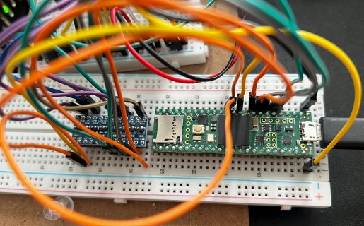

I've replaced the Arduino Uno R3 with the Teensy 4.1 and have been able to get Teensy animations like "Blink" to work fine with the native LED on the Teensy.
But the moment I try to output from the pins, I don't get any light from my strips (I'm hoping for obvious reasons to someone here, Paul? haha)
Admittedly, I am much more a hobbyist at this (more on the music side of things) and while I've gotten fairly comfortable with the Arduino, I really feel in the weeds here and wish I wasn't posting in the forum in such desperation (there's likely to be some noob mistakes, seemingly on the hardware end?).
I've tried implementing the OCTOWS2811 library (which, it's my understanding still works with WS2812B LEDs) mixed with the FastLED library (thanks for the heads up, Lucas Morgan), but feel mixed up with whether to use LEDS.addLEDS... or FastLEDS.addLEDS... or whether it's a separate issue altogether.
It seems like the best bet ultimately is to implement the physical OCTOWS11 Adaptor and solder ethernet connections to my strips. But I didn't want to commit to that until I've made sure it's not just my code/hardware implementation. (it's my understanding, you don't necessarily need the physical adaptor, it+ethernet just speeds things up).
I've attached some reference photos along with my code below. I can upload new photos as needed, just wanted to get the conversation started.
