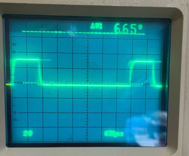

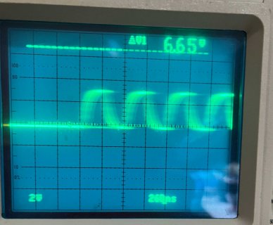

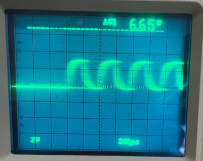

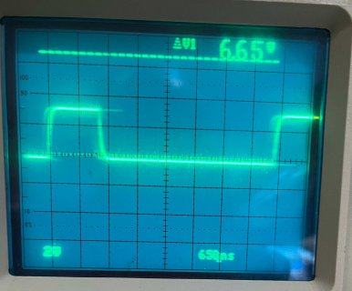

Thanks for the quick reply. I do have an oscilloscope. How would I detect the signal ringing? And which lines are the data and clock signals?

@mskl99 (Mike): If you have wired things in the typical fashion, the signals mentioned above (MOSI, pin 11 on the Teensy & SCK, pin 13 on the Teensy) will be the ones most likely to be ringing (ringing: you'll see where the base-level square wave has extra high & low transitions instead of a sharp low-to-high or high-to-low, clean transitions). The extra transitions from this ringing can be misinterpreted as either extra clocks (on SCK) or wrong bits (on MOSI). Make sure that you have a very good ground connection to your o-scope probe when measuring (as short as possible, and as close to the signal that you are measuring as possible). Measure the signals both at the Teensy end of the wire & at the display end of the wire. I forgot to mention that the inline resistors, if you choose to try that fix, should be placed as close to the Teensy as possible (even better if you are able to cut a trace on your PCB & put them right next to the Teensy).

Thanks for the help. With the longer ground wire (display doesn't work), I measured the signals at MOSI and SCK pins on both the teensy and the display. Images are attached. They aren't great quality tracings, but I don't really see any ringing. Should I go ahead and wire in the 100R resistors on the PCB?
BTW, the signals basically looked the same with the short ground wire and the display working properly.

It's an old Tektronix 2445 150MHz scope. Noise rejection is off. There is a 20MHz BW limit button which is not pushed. I agree that the square waves look like the high frequencies are attenuated.
I reduced the clock speed to 24MHz and was able to add 3 inches of length to my ground wire. I will install the 100R resistors and see what happens.
