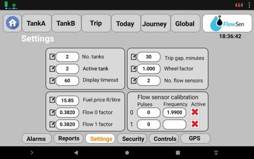

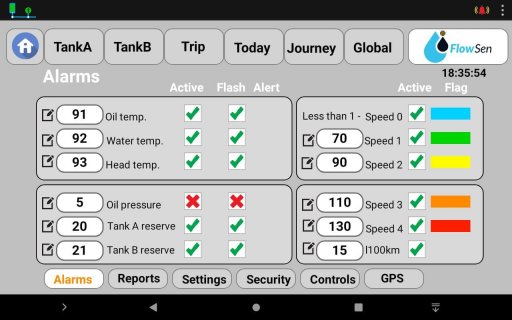

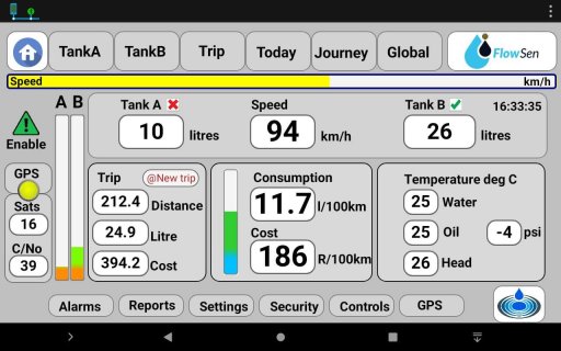

If you are wondering about the large text size in my Android app that is because I needed something that could easily be read at a glance while driving, even in bright sunlight conditions, which applies to my part of the world.

This is a very interesting project, quite similar to mine but with a different emphasis. You are concerned with monitoring modern high performance engines whereas my emphasis is on fuel usage of old fashioned diesel engines that lack electronic fuel injection. That was my brief, which was just too bad. I would have liked to measure fuel consumption by measuring the pulse width of the signal to the fuel injectors as that would have made for a more interesting project. Instead I am measuring fuel flow(using flow rate sensors) to and from the fuel distribution manifold. The difference is the fuel used by the engine.First prototype of my Dashboard https://github.com/NicoEFI/GDash
