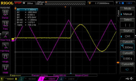

First I would like to thank Kenny Peng for coding the waveshape example that I could build from.
I wanted to experiment with the waveshape effect in Teensy Audio for use with electric guitar and organ.
I found that is was best to test the math I would be using and visualize the shape curves first with the Processing 3 program.
I started with the sin function making a curve shape that is essentially a triangle wave to sine wave converter.
Then I applied the sin function on it self by putting the shape array thru the sin function again.
I continued to do this again up to 8 times.
The result is progressively sharper curves for waveshape.

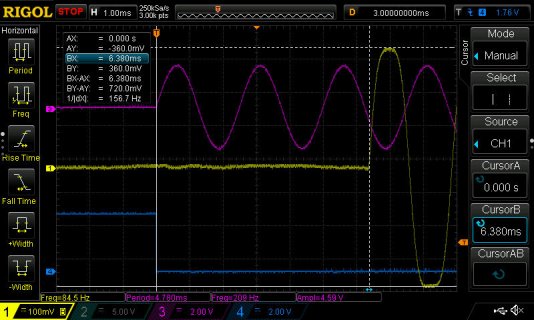

With that done I converted the code to Arduino C for use with the Teensy 4.0 with Audio Shield.
I also added a power supply, a one transistor impedance buffer to the Audio Shield input and true bypass wiring to the circuit of the pedal.
This actually sounds pretty good for a guitar distortion effect.
It will get progressively more noisy at the higher settings but is still a useful effect.
It has the ability to be clean on most settings as long as you turn down the guitar volume enough and play very lightly or be a heavy lead distortion when you turn it up and play more heavily.
It is also useful on keyboards to give that organ patch a bit of a grind sound.
I will try different algorithms to apply different shapes in the future but this is enough for now.

I used my scope and generator to do a latency measurement.
Its latency measured at 6.38ms.
https://forum.pjrc.com/attachment.php?attachmentid=31252&d=1686190142&thumb=1&stc=1
6ms is a bit high if you are mixing in a dry signal elsewhere. If you want to reduce the latency cut the number of samples in an audio block down from the default 128.
Edit .../cores/teensy4/AudioStream.h and change AUDIO_BLOCK_SAMPLES to 16, recompile and re-measure the latency
cheers, Paul
@Isrichard - changing AUDIO_BLOCK_SAMPLES shouldn't change the way the pedal behaves or the sound of your effect at all (other than latency).
By default the library processes sound in blocks of 128 samples (128 samples at 44.1kHZ = 2.9ms) reducing this just means that audio is processed in smaller chunks (16 samples = 0.3ms). It adds a bit of processing overhead but a teensy 4 has lots of capacity for processing. Most of the objects in the library work with reduced blocks and if they don't they normally fail very noticeably (the only one I've come across that doesn't work well with it is the USB Audio out, there may be others that fail that I haven't come across). Cheers, Paul
AudioStream.h lists following as problematic with lower block sizes
- AudioInputUSB, AudioOutputUSB, AudioPlaySdWav, AudioAnalyzeFFT256, AudioAnalyzeFFT1024
