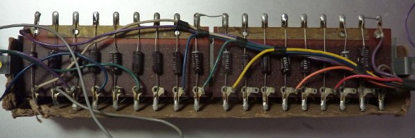

So I found an old Hammond vibrato line-unit on eBay:
These are basically multi-stage LC delay units that connect to a wonderfully old-school rotating scanner
unit (which I won't go into here...) - the various delay taps are effectively interpolated between as the
scanner rotates.
The line-unit taps used can be selected by a complex switch array, as the iconic Hamond B3 vibrato/chorus
unit has 19 taps of which 9 are used at a time.

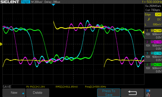

Injecting square wave signal into the line-unit and looking at a variety of taps, the first few:
and every 5 taps or so:
Shows the progressing delay and the ripples in the response due to the analog filtering of the LCR array.

Taking several traces from various taps (with the code modified to output 30% of the zeroth tap plus a
specific other tap):
Shows that the simulation is producing similar time-domain signals, and delays. The zeroth tap signal produced an
initial rising edge for triggering the 'scope, this was purely for aligning the traces - this image is actually a composite
of 5 separate traces overlapped by post-processing the images. The code doesn't do this, it passes the various taps
to a simulation of the rotating scanner.
This convinced me the code was doing a plausible job of simulation of the line unit, as well as the sound of it...
