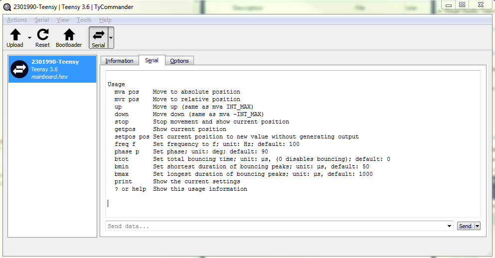

If you want to quickly check whether the problem lies in your hardware or the your code you can run encSim on a second Teensy. (see here: https://github.com/luni64/EncSim.
It generates quadrature signals with or without chatter, adjustable frequency and phase. It can be controlled by a simple serial interface. The repo includes precompiled .hex files for a quick upload to a T3.2 or T3.6.
Hope that helps
Hope that helps
