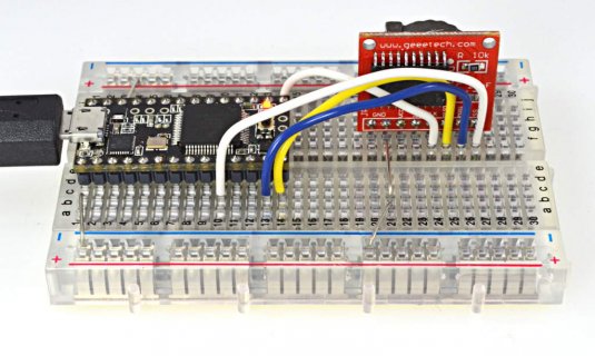

Are you using a breadboard with the DS3234?
What is your SPI speed for the DS3234?
beta 8
I'm using the Sparkfun Dead-on RTC on a breadboard.
SPI speed was whatever the Sparkfun example uses - presumably the default
Pete
Thanks Pete
I finally got the SPI DS3234 RTC working intermittently using solid connections (no breadboard). The breadboard adds stray capacitance to SPI signals.
In the Sparkfun example, I had to change the SPI mode from 1 (default) to SPI mode 3. Default SPI Mode 1 never did work for me?
SPI signal "wire separation" or shielding is very critical in making this device work?

I use SPI mode 1 and the chip is powered from the T3's 3V3. This is on a ratsnest breadboard with several other things as well. If stray capacitance was a problem this wouldn't have worked at all :D
[edit] However, I have previously had problems with breadboards which always came down to poor connections. Moving the circuit to a new breadboard always, so far, solved the problem.

The board arrived from Geeetech some time ago. With all the hurry to get ready for Maker Faire and then to release 1.14, it got put into a big box of hardware waiting for me to test Arduino libraries and hasn't been touched since.

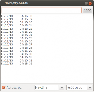

Ok, I connected the Geeetech RTC on a breadboard this morning. I ran this example code. It appears to work perfectly. Here's a screenshot of what I'm seeing on the serial monitor:
(click for larger)
Here's a photo of how I connected the hardware.
(click for larger)
I tested with Arduino 1.0.5 and Teensyduino 1.14 using this board and the example program without any modifications. The Greeetech RTC module did not come with a battery. I tested without a battery installed.
Andy, could you try again using relatively short wires?
The Teensy 3.0 has very high bandwidth digital signals for its SPI port (much higher than AVR-based Arduino). Maybe the trouble you're seeing could be crosstalk or other signals quality issues related to the very long wires?
Maybe the trouble you're seeing could be crosstalk or other signals quality issues related to the very long wires? .
Yep --> shorten all hookup wires from 12.5" (31.75 cm) to 2"(5.08 cm).:)
These long wires worked perfect on any Arduino?:confused:
Remote panel mounting the DS3234 RTC module away from the T3 cannot be done. :(
Again, you help is very appreciated Paul "Superman" Stoffregen !!!! :cool:
BTW ... thats a very cool breadboard you have Paul.
addition: Strange, but only SPI mode 3 works but not SPI mode 1 ?
Glad I could help. :)
Teensy 3.0's ARM chip has much higher bandwidth on its pins than AVR. Fast digital signals can be problematic on long wires. Usually crosstalk and signal reflections are the main issues. You can sometimes make a pretty substantial improvement by adding a resistor between the pin and the lengthy wire. See the "Signal Quality" section on the OctoWS2811 page for an example. The resistor value depends on the type of wire and the spacing between the wires, but usually resistors in the range of 50 to 300 ohms are about right. Without an oscilloscope, you're really shooting in the dark, but even getting somewhat close can make a big improvement in the signal quality compared to not having any resistor at all.
Those "clear" breadboards look nice, but I think they're actually harder to use. It's easier to see wires against an opaque white breadboard. I had this one laying around because PJRC bought samples of a couple dozen different breadboards to evaluate how well the header pins fit. The BPS and Twin ones were far superior (we're selling the BPS one now). This was left over in the pile of, well, not-so-superior breadboards. It looks cool, but it's in about the middle of the usability range. The BPS and Twin ones are definitely the best.
