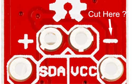

I'm putting up a pic of part of the back of the Fuel gauge board. On this, the battery is marked with the + and - and then there is the vcc pin on the right hand side. From what I read in the discussions I quoted, they are talking about cutting the trace that runs between the vcc pin and the + terminal pin of the battery, so like at the position of the minus (-) sign. So, I would just cut the trace right there? Just take an exacto to the back of the board and cut it?
Again, thanx for all the help.
It looks like all you need to do is separate the battery input from Vcc, and then connect Vcc to the teensy3's 3.3v output.
They're powering the chip from the battery apparently, when in your situation, it doesn't need to be. You need to power the gauge with the teensy3 instead of the battery, so you can keep the 4.2v isolated from the teensy3. As far as what trace to cut on the board. that LOOKS like where you need to slice the trace.. but it's 1am.. and sparkfun has apparently liked to flip their boards around when taking pictures.. so.. best get a second opinion. heh.

I went ahead and cut the trace today. Now I have to make sense of the libraries I found for this thing.

Today I received one of the Sparkfun boards in the mail. I cut the VCC trace as suggested in a previous post and wired everything up. So far, so good. No magic smoke and the data appears reasonable.

So I wanted to confirm that cutting the indicated trace wasn't fatal and seems to work fine.
