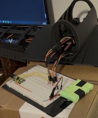

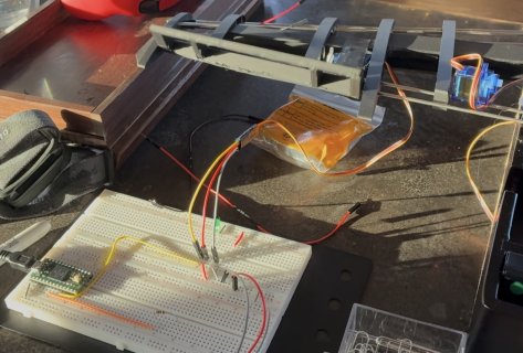

In the meantime, I would like to ask a question about how to best power the teensy externally for my application. I am building an RC plane and using the teensy as a flight controller. It will be attached to an ESC (controlling the main motor), multiple servos for the flight control surfaces, radio receiver, and sensors to calibrate the teensy as a flight controller.
The ESC/main motor is powered by a 22.2V battery while the control surfaces are powered by a separate 6V battery. The ESC releases 5V on its control pin and can power the Teensy but I was hoping to power it via the 6V battery in the hopes to maintain radio/flight control incase of power loss to the main motor.
Would you recommend the 6V power system or to stay with the 5V ESC control pins.
I additionally attached two photos (captured from video sorry for any quality issue) of previous servo motor control tests with the 6V battery and the teensy being powered by the usb and only sending signals to the motors. Is that circuit possible with just the 6V and no usb?

Those photos don't really help much. Can you just wire it up powered by external 5V as described as not working in the first post and take a picture?
It sounds like the easiest way to power it would be taking the 6V from the battery through a basic power diode (e.g. 1N4004) to drop the voltage to around 5.3V, which would then be safe to feed to the Teensy's 5V VIN.
Besides the possible wiring issue, also keep in mind that the maximum voltage on the VIN pin is 5.5V. You cannot directly connect 6V. If you want to use the 6V battery, connect a silicon diode in series between the 6V battery and the VIN pin to drop it down to a safe level.
