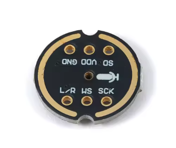

I'm wondering how i should connect the 4x MEMS microphones to the Teensy 4.1?The micromudles have 6pins
Do i just have to adjust the 'L/R" pins and the "SD" pins on the Teensy?
And can i then couple together all the other pins to the Teensy pins?
Or do i need to connect 4x4 pins of the MEMS to 4x4 different pins on the Teensy?
Before I try to answer, please understand the only if I have is the photo you shared. I can't even know which MEMS mic is actually on that circuit board. If this answer isn't enough, please try giving a link to the product or a datasheet or other specific technical info.
I2S is a stereo format. Usually I2S MEMS microphones have a way to connect 2 to the same data wire, where one transmits as the left channel and the other transmits as the right channel. Usually the mic provides a pin you wire to either GND or 3.3V to configure which way it transmits. My guess is that's the purpose of the L/R pin. (remember, most of this answer involves guesswork because you didn't give specific technical specs about those MEMS mics you are using)
So the 3 simple pins are GND, VCC (3.3V) and L/R.
I2S receive on Teensy has 4 signals: RX, LRCLK, BCLK, MCLK. You will probably use the first 3 of these and leave MCLK unconnected. Many other audio chips need MCLK, but MEMS microphones almost never use MCLK.
For each pair of mics (one with L/R wired to GND and the other with L/R wired to 3.3V), you would connect their SD pins together and wire them RX on Teensy. Likewise, wire both WS together and (probably) connect to LRCLK. Same of SCK, wire them together and connect to BCLK.
On the Teensy software side you have a few choices. The simplest in the Design Tool would be i2s_quad.
If you're not familiar with the design tool or how to use the audio library, this 31 page tutorial (or its 45 minute walk-through video) is the best plage to start.
When you click on i2s_quad, you'll see its documentation appears on the right side panel. This is where you can see which pins to use on Teensy.
So to connect these 4 mics, you would wire each pair of SD pins to each of those RX pins on Teensy (pins 8 and 6 on Teensy 4.x). Wire all 4 WS pins to LRCLK (pin 20), and all 4 SCK pins to BCLK (pin 21).
You haven't said how long your wires will be, or what type of wiring you intend to use, but since you're wanting to connect 4 microphones my guess is you will want them spread apart by some distance so you're not just receiving 4 virtually identical copies of the same sound.
I2S is not meant to communicate "long" distances. It's meant to be kept on 1 circuit board spanning a short distance of only inches or centimeters. Normally the signals are meant to be routed with a ground place underneath, or at the very least with a GND wire among the traces.
The farther you try to communicate and the less your wiring looks like a PCB with ground plane, the more you will run into challenging signal quality issues.
One common technique to improve the signals involves adding a 100 ohm resistor between Teensy outputs (LRCLK and BCLK) and the wire traveling to the microphones. If you use 2 wires for each signal, best to have 2 resistors connected to the Teensy pin and connect only 1 wire to each resistor. If 4 separate wires, use 4 resistors so you have 1 per wire.
Likewise, if you have long wires you might get better results if you also add a 100 ohm resistor between each SD pin and the wire it drives. Like with the pins on Teensy which transmit the 2 clocks, those pins on the mics are transmitting data into the "long" wire. Adding a resistor between the transmitting pin and the wire can really help with signal quality problems.
Even with resistors, you should understand I2S is not meant for long distances. Series resistors between each transmitting pin and the wire it drives can help, but don't expect miracles. For long distances you really want a low impedance analog signal, not I2S which is designed to be used between chips soldered to the same circuit board.

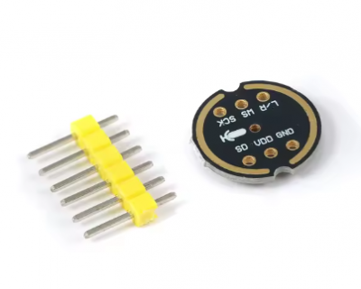

Hi Paul,
OH THANKS for clearing things out for me !!
The MEMS are type "ICS-43434" (see picture below & params)
Wire will be as short as possible !! (i hope less than 6cm long)
I intend to make a special casing on the RPi+Teensy combo with 4 directional very low dishes (just to be able to put some stockings on top to prevent rain and dust creeping into de MEMS mics.) - so those dishes are not ment to compact the signal into the MEMS, because those MEMS are not ment to be for that i think. All will be powered in the field with a 30.000mAh powerbank 5V - 4.25Amps to work for 6 to 8 hours of "bird-migration-counting" with some spare powerbanks if needed.
This year with monitored 860K+ migrating birds for example by visual recognition, we would like to get into the NocMig - "Nocturnal Migration" too with this apparatus ... I've been on Arduino and ESP some time ago, but still had the Teensy in the drawer - and would like to use it now for this project.
I hope to get those MEMS the next day and will start on breadboard prototyping first before making a proper PCB.
Then i will try to write some code (trial and error will do just fine for me :cool: )
I already had a look at that AUDIO-Tools, looks awesome, but a bit strange too for me, will have to walk through the manual then :)

If you want to capture all migrating birds from all directions, I would suggest using one single electret mic, eg. AOM5024 or EM272.
The ICS43434 are MUCH noisier and -even more important- much more sensitive to moisture and rain. So, with the AOM5024, you will record more birds because of their lower self-noise.
I have two BirdNET-Pi continously running for more than 3 years now using AOM5024 without any rain protection, only a small foam windshield. They still work perfectly. Electrets are very robust.
Also, BirdNET processes only one audio channel, even if you record Stereo files.
BTW, omnidirectional really means "from every direction", so one omnidirectional mic will cover all migrating birds over your head.

And still i'm thinking about those MEMS also,
