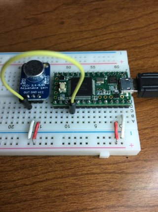

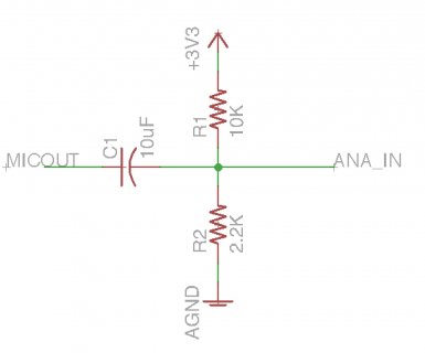

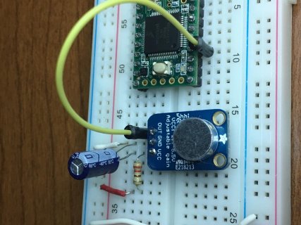

I'm getting results I don't understand from this setup on a Teensy 3.2:
and this physical setup
The mic is an Adafruit Max4466
and using this code:
Serial monitor results start with
Sound input cause all three measures to respond appropriately, but with an increasing, and eventually fixed, non-zero baseline... always (in my setup) with values of 36, 36 and 57.

I'd expect the values to return to (or near) zero.
I'm also expecting I've missed something fundamental.
What am I missing?
Thanks in advance!
