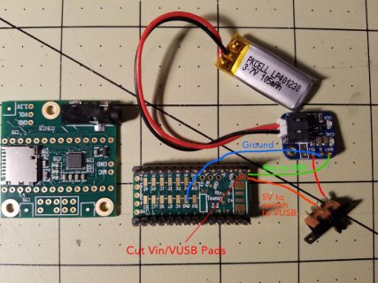

Hi All,
I'm using a Teensy 3.2 with the Audio Adapter and am wanting to power it with a Lipo battery and accomplish the following:
1. Micro USB is used to program Teensy as normal
2. Micro USB is used to charge Lipo battery
3. Micro USB can still be used to power Teensy
I am piecing information together from several sources:
1. Using External Power and USB
2. Use an Adafruit LiPoly/LiIon Backpack Charger with a Teensy
Attached is a pic of how I think it needs to be connected.
Do I still need to use the diodes as described in "Using External Power and USB"?
Thank you!
