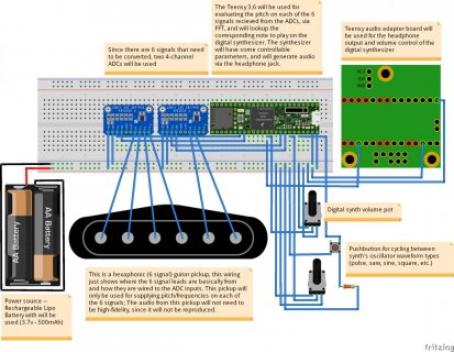

Thanks -- though the Teensy would be outputting audio as well when using it as a synthesizer or for applying effects to either the guitar's or synth's signal -- but I do not need to *reproduce* the 6 audio signals I'd be getting from the hexaphonic pickup - those signals are just for tracking the notes and strings played on the guitar. I will draw up a sketch of the concept and attach it a little later to make it more clear. Thank you!

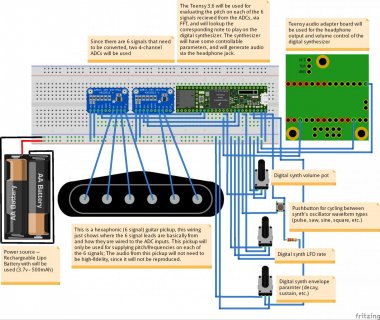

Blackaddr, please see the following image that I made with Fritzing which details my thought process on this and how I think it might work (from an off-the-shelf / prototyping standpoint) -- I'm sure I'm missing some things, but this is basically what I could come up with.

I'm still not sure, from a hardware perspective, if the components I plan to use will do the job. I'm not using the 1/4" guitar cable jack as the analog input, but instead I'd most likely be using the 6 raw lead signals from the hexaphonic pickup. I think that passive guitar pickup signals are unstable, and so I'm not sure if this multichannel ADC (https://www.adafruit.com/product/1083) would be able to amplify the raw signal to the right voltage that the Teensy can use. I'm also not sure that the Teensy cpu and dynamic memory can handle processing 6 signals coming over on 2 concurrent I2C connections. I did some reading up on it, and I think the Teensy currently only supports quad (4) ADC channels via I2C (or maybe it's I2S?). However, looks like a little while back Paul added "TDM" support to the Teensy that can handle 6 audio inputs or something of that sort and there's a board for it on OSH Park's store (the CS42448 Audio board).
Maybe Paul could chime in if he has some spare time? Would be greatly appreciated!
The datasheet for the ADS1015 says the input impedance depends on the FSR (PGA) setting, but is generally in the megaohms, so that is good. The FSR (full scale range) can be set as low as 256 mV. You will need to know the amplitude coming out of the pickups. A conventonal vintage, single-coil can be as low as 10s of mV after combining all 6 poles. I"m speculating here that a single pole on a hexaphonic pickup could be less than 10 mV. That means the you could be losing say, 4 bits off the top end, so your 12-bit ADC acts more like an 8-bit adc.
You need to measure the output of the pickup you intend to use, and decide how many effective bits of resolution you need in the sampling to determine if you really need a preamp (6 preamps really). I would try without a preamp during prototyping and go from there.
