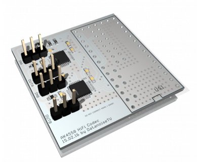

Hey guys, I have made a version of this board in Eagle, with some changes (4 outputs and inputs). It was inspired by the
Teensy Audio Board.
I would like to get some feedback from you. The ground is stiched and analog VDD + analog GND are separated.
Note: Decoupling Caps for DC left out intentionnally, in case DC output is needed.
You probably need to connect CAD0 high on the 2nd chip, so it'll have a unique I2C address.

Hello,
I just received my boards for my design and soldered the QFN28 AK4558 - pretty sure there are no bridges and the connections are right.

But the Audio Outputs of both DACs stay at 0.0V.
Edit: Scanning I2C also is without success - something must be wrong I think.

I'd focus on getting the I2C scanning working first.
With the SGTL5000, there's no response on I2C without MCLK present. I don't know it that applied to AK4558.
I agree paul. I have been trying to run I2S and then scan for devices, but still without any success.
Measurements show that SCL + SDA on the Codec side have ~1MOhm Resistance to GND, which seems right.
SCL + SDA are pulled up by 2.2k - I have checked with a logic analyzer and that also looks all fine.
I have verified that there are no bridges on 2 boards I made and that Initialization is done as described in the Datasheet.
I have now found the following on the original authors article:
I could not understand why the codec would not output anything even if I double checked the registers' configuration parameters until I put a function that reads their values AFTER I performed my I2C write operations: everything would read as 0 (zero). That was the moment when I grabbed my logic anaylizer and attached it to the I2C bus and found out the truth: I performed an out-of-bounds write when trying to write the Power Management register, meaning that every other operation performed on the bus after that one would not go well. In particular, when I was trying to write that register I put the CODEC I2C address instead of the Power Management register in the function (which is out of bounds).
Maybe its related.
I get that you are unable to start basic I2C communication to the devices.
You should first of all modify my library; since the I2C address is hard coded in the lib, you could set the #DEFINEd address for IC#1 and use a dynamic boolean value to add 1 to the hard coded address. E.g.: #1 has address x+0, #2 has address x+1.
Then, you shall try to readInitConfig() from both ICs, and see if you get the default configuration from both (you can find the default settings for all registers in control_AK4558.h). If that's not the case, you shall check with a logic analyzer what happens on your I2C bus.
Anyway, I see that you defined CAD1 to 0 and CAD0 to 1, while you say that you have pulled up pins CAD1 and CAD0 with 2.2 K, so you might have your address wrongly set. Secondly, you could just #DEFINE CAD1 and CAD0 in your user code, not in the library itself (that's what #IFNDEFs are for).

Found the mistake - I2C SCL and SDA swapped in eagle. Also, PDN pin was hardcoded in MickMads Library to Pin 0, and on my board its Pin 1.
Still, there is no valid output on the DAC.
