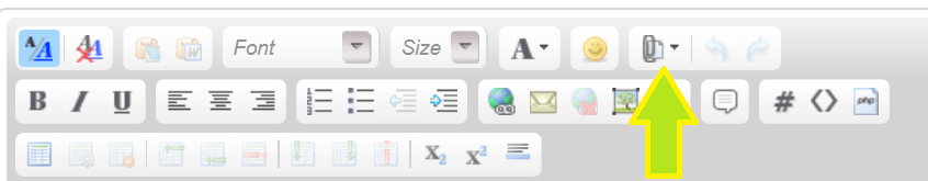

ZIP and some other files can be uploaded. In the lower right of the post edit block is 'Go Advanced' - clicking that exposes more items on the edit block toolbar.
That image should look similar - with an arrow added to the 'Attachments' button that allows pointing to a ZIP file where AFAIK size is limited to something over 1GB.
