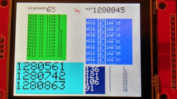

@vitor - I added two more scrolls to my sample and started getting :: Serial.println(cursor_x);
In ili9341.cpp it is line #861.
Running without flaw or problem on 4 simultaneous scroll sub windows! [ with other active prints ]
View attachment scrollTest2b.ino
<edit>: here is a single file sketch - dropped extra font - runs 4 scrolling windows at the same time [odd lines, even lines, millis, delay value wait between updates] , with static text of millis written as well, a busy char rotator.

Scroller Movie on OneDrive
<edit: I had to watch the movie in Firefox and it worked - my IE has been adjusted to not do some active content>
The Slowdown is sometime before August - and happily I don't see any slowdown from the scroll additions. And the movie shows it runs pretty quickly. The lower right corner shows the delay time between each iteration of the "for (int ii = 0; ii < 40; ii++)". It has been running overnight so the lower left ms has naturally jumped to two lines.

I was seeing screen burn under Navy and Blue - so while updating my SCROLL example I started shifting the colors across the 6 active scrollers. I enter and leave the scrollers often and quickly and with adafruit or PJRC font and the only oddity I found worked around using the PJRC font and its height not being hard coded math like the Adafruit one showed an overwrite anomaly that doens't appear when using the scroll without exiting.
So here is my spastic sample with 6 flying scrollers and 4 other added active onscreen elements working well - you need the PJRC ComicSans include as in Vitor's first sample. To test I cycle and grow each of the 6 scrollers after 40 prints for 18 passes to cross common font height boundaries - then I rotate the fgc/bgc through to reduce screen burn. I also cycle the font used and I see a small problem - one pixel high on one scroller with ComicSans - I emailed Vitor about. Also sometimes the one text string 'cnt=' outside a scroller doesn't show.
View attachment scrollTest2e.ino
PS: I really like the looks of the scrolling code.
