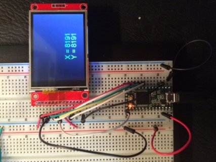

Problems accessing SD card when using Audio & High Speed Graphics Lib
I have a number of T3 with Audio Shields and both touch and non touch displays from the PJRC store. I have them wired up (2 of the sets anyway) and If I load the wave player example I can get the player to work, also if I load the graphics example I can get the graphics to work. however If I merge the two samples together I get an error 'cannot access SD card' I just D/L'd Arduino 1.6.8 & TD 1.2.8 B2 and I'm getting the same results. I'm not sure where to look for the problem next. I was hoping to get some advice here on what to look into.
Here's a sample 'minimal merge' where I took the wave player example and started adding in accelrated graphics code until the sketch won't access the SD card anymore. it happens with call to tft.begin. If I use the Adafruit 'sloooow' lib I can merge the two sketches successfully the graphics and audio work but the graphics are of course not accelerated. Has anyone run into this and solved it or could someone point me at what to look into?
Thanks Kb
Here's my merged 'sample' of course it's dependent on the sample audio files to fully work but you can see the issue by simply uncommenting the line
//#define T3_ACCEL 1
To use Acclerated library and that causes the problem, neither Touch nor SD work if using the accelrated graphics lib

I tried getting the XPT2604 lib to work with my ts to no avail... here's the result, basically the screen display x=8191 y=8191 and flickers to no end. no touch events captured. the code i used was the ILI9341TEST that came with the lib i downloaded from the link from defragster (thanks btw) here is a pic and the code from the sketch i used

here is the back of the screen, i've connected the t_cs to pin 8 and t_irq to pin 2. I don;t know what i'm doing wrong, and i most obviously am, but any help would be appreciated as i'd like to run the teensy 3.2 at at least 72MHz optimized as opposed to 24MHz to stay synced with the UTouch lib
Dropped that code on the unit here and it runs perfectly. Both handwired and the OSH_PJRC purple test boards.
I got another 128x128 display only unit, and like yours it had a yellow header spacer (the PJRC 2.8 and similar have black) - on that unit it came with a modified display driver chip sumotoy had to account for in code - but that was a video map offset. I'm wondering if on your board they changed the touch controller?
Having written the above - and thinking of the library code - it is quite likely with the change in display area - and thus the resistive sensing area the limits and values measured are changed. Your touches are being SEEN, but need different math to map them to the display area.
I don't see a source point for your UTouch library . . . if I saw that I might see if that is the case. Please link me to the code you are using.
