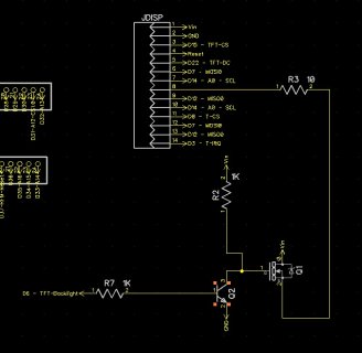

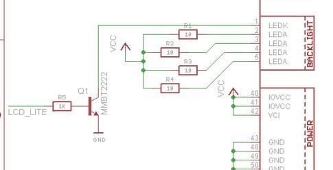

Hi
i am using a 240x320 tft display ILI9341. I am using the optimized ILI9341 library. is there any way to turn off the backlight? i noticed there is a Display off defined in the library as 0x28. i dont have a seperate lite pin on my display to control the backlight and can't power the backlight from a teensy digital pin either
Thanks
My guess is probably not. That is with most of the displays you have a backlight pin, which you can feed it power. You can also hook up circuit to then control brightness using PWM pin... Some like Adafruit I think have this circuit built in.
But without the pin, don't know any way
Edit: out of curiosity which display are you using? Have a link to it? It might have additional information
I don't have a link for the datasheet but its the same one listed in the PRJC website
it does have a LED pin to power the backlight but I believe it needs 3.6 to 5V for normal operation and would draw like 20mA and teensy digital pin can't do that
You are right that you could not connect it directly to an IO pin.
The Adafruit display has stuff on it to allow it's backlight pin to be connected to IO pin... It takes the negative part of the backlight circuit through a transistor.
Earlier I did a board based off of stuff I saw on FrankB's board, using two transitors.
Where at the time (a few years ago Q1/2 were:
1 BC850CLT1GOSCT-ND Q2 BC850C SOT23 3
1 BSS138CT-ND Q1 MOSFET-NCHANNELBSS138 SOT23-3 3
But these days don't have clue what things are available and/or others may have easier/better circuits.
In my experience, some «*red ili9341*screens » have a transistor already attached to the LED pin in which case you can directly PWM the backlight from a teensy pin… you can probably check on the PCB if that is the case for your screen.
thanks for the replies!
yes my screen does have that transistor Q1. My screen is the same one that is in the github link that you posted. Is there any command that I can send to the ILI9341 to control this transistor? I don't see a way to directly connect a teensy pin to this transistor
Thanks again
If you have the transistor on the board, then you can directly connect the LED pin from your screen to any digital pin of the Teensy without any additional circuitry. Then, you can PWM the pin to dim the screen as you wish...
With the transistor in place, the LED pin will only draw a few mA of current. However, jut to be on the safe side, you can check that this is the case before connecting it to the Teensy: just wire the VCC and LED pin to +5V and GND to ground and measure the current flowing respectively through VCC and LED with a multi-meter. You should get something like 50mA for VCC but only maybe 5mA for LED...
