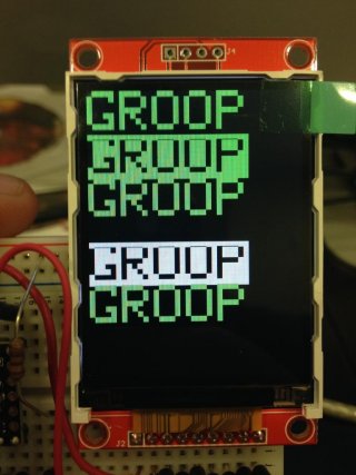

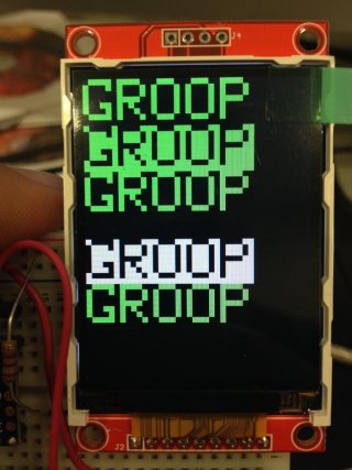

@Paul: I just tried out the latest ILI9341_t3 from the github repo and it seems the current drawChar optimizations leave out
the lowest line of a character. Just run the graphicstest example and lookout for the clipped p y g characters in the testText() test.
Aside from that, the ILI9341_t3 lib rocks! Thanks for the hard work...
Fix for the drawChar problem:
Look for this in the drawChar function and replace:
for (yoff=0; yoff < 7; yoff++) {
needs to be:
for (yoff=0; yoff < 8; yoff++) {
and
for (y=0; y < 7; y++) {
needs to be:
for (y=0; y < 8; y++) {
Works so far here...

Still something odd in ILI9341_t3::drawChar?
This is really fantastic! And I love the discussion about fonts.
I just fired this up with a T3.1, 1.20rc2, and pulled the master of ILI9341_t3 from GitHub.
I'm seeing something strange with scaled text drawn with a background.
To distill it down, I chopped up graphicstest.ino so it would do only this:
  tft.setCursor(0, 0);
  tft.setTextSize(6);
  tft.setTextColor(ILI9341_GREEN);
  tft.println("GROOP");
  tft.setTextColor(ILI9341_BLACK, ILI9341_GREEN);
  tft.setTextSize(3);
  tft.println();
  tft.setTextSize(6);
  tft.setTextColor(ILI9341_BLACK, ILI9341_WHITE);
Photo attached with the screen that results from the above code.
The top line of the scaled text is drawn with just one pixel, and the top few scan lines are drawn with background instead of character dots. Also, it looks like the fg/bg text is drawn one pixel too low, as you can barely see that the green text is slightly over the top of the reversed white text in my attachment.
Before:
I don't know if this is correct because I've only read drawChar and not the rest of the file, but I saw two things that didn't look right to me. First, I don't know how setAddr works but it didn't look right to subtract one from the width but not the height:
setAddr(x, y, x + 6 * size - 1, y + 8 * size );
so I changed this to:
setAddr(x, y, x + 6 * size - 1, y + 8 * size - 1);
That fixed the size of the background but now the whole top pixel of character data is drawn as background, so it looks like it's being overwritten.
There's code at the end of drawChar that wants to write one scaled line of pixels in the background color, the 8th row of pixels that doesn't have data in the 5x7 font:
uint32_t n = 6 * size * size;
do {
	writedata16_cont(bgcolor);
	n--;
} while (n > 1);
writedata16_last(bgcolor);
But the loop already writes that 8th horizontal line of dots (it's nominally a 5x7 font, but the data is 5x8 and the loop draws all 8 lines).
So I ended up with the last lines of drawChar looking like this:
		// This solid background approach is about 5 time faster
		SPI.beginTransaction(SPISettings(SPICLOCK, MSBFIRST, SPI_MODE0));
		writecommand_cont(ILI9341_RAMWR);
		uint8_t xr, yr;
		uint8_t mask = 0x01;
		uint16_t color;
			for (yr=0; yr < size; yr++) {
				for (x=0; x < 5; x++) {
					if (font[c * 5 + x] & mask) {
						color = fgcolor;
						color = bgcolor;
					for (xr=0; xr < size; xr++) {
						writedata16_cont(color);
			mask = mask << 1;
// 		uint32_t n = 6 * size * size;
// 		do {
// 			writedata16_cont(bgcolor);
// 			n--;
// 		} while (n > 1);
// 		writedata16_last(bgcolor);
		SPI.endTransaction();
After:
Now appears to draw correctly, but I then noticed that someone went to pains to make sure the last data is written with writedata16_last() instead of writedata16_cont(), and I didn't do that, so I'm sure that will have to be fixed, but before I go any further, maybe someone can take a look and see if I'm on the right track. Glancing at writedata16_*, I see that there is some SPI handshaking that needs to be done, and my edits break that, which will have to be addressed by someone who knows what they are doing with Teensy's SPI.
Thanks!
-Dave
