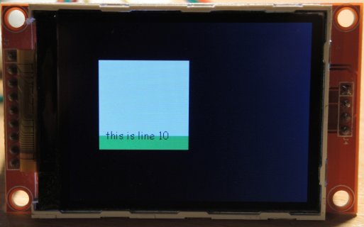

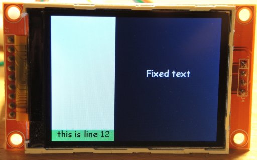

I have a problem with running ScrollTest on 240x320 TFT ILI9341 display with Teensy 3.1.
When text line 10 printed at the bottom, the area above it is filled with white and stays empty, bottom line of text keeps changing from 'text line 11' to 'text line 19'. Both in full screen scroll area and in smaller one. 'graphicstest.ino' from 'Examples' runs without issues. Arduino IDE 1.8.19.
Code from ILI9341_t3n-master\examples\scrollTest\scrollTest.ino (comments removed):

Screenshots in attachment.

Wow! Connected MISO and it works now. I was always sure MISO is not used by displays. And it says everywhere 'is not required if the SPI bus is used only for the display'.
Thank you!
Pretty sure it’s needed for scrolling text to work. Some displays may not implement it [correctly], there’s a lot of variants out there…
The code that does the scrolling does:

This works one of two ways:
a) If you are setup and using a frame buffer, the readRect simply copies out of the frame buffer memory.
b) It actually reads the pixels back from the display. Which requires MISO pin.
