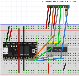

Thanks for your fast answer Paul !
I already tried these connections but it's not working. I'm using a CD4050 as level converter (5v of teensy to 3.3v of ILI9341).
The "graphicstest" of the original Adafruit_ILI9341 Library worked too, so I don't undertand why your library don't work properly.
Which teensy? Which display? Teensy 3.x are all mostly 3.3v with 3.1 being 5v tollerant.
Which pins do you have connected to what?
Also, when you say it's not working; what exactly is not working? Failing to compile? Doesn't show anything in Serial Monitor? Doesn't display anything?
Need some details in order to help you with regard to this. =)
Yes, sorry I didn't explain my problem too much.
I'm using a Teensy 3.1. Does it have 3.3v logic level ??
The screen print nothing but the benchmark work :confused:

This is my wiring (in attachment)
I hope this can help you to find where is the problem
No ... wait ... it's working !
The only thing I do to fix it, is moving a bit jumpers. I think there was bad connection (due to bad quality jumpers or breadboard).
Thanks for helping me :)

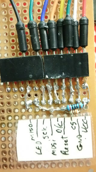

I hooked one up following the connections on PJRC direct to a 3.1 and it worked. I soldered mine to perf and then socket jumpers and was right the first time - fast and reliable.
This seems to be a good idea but do you have any pic (to reproduce it :) ) ? Because I didn't understand the socket jumpers usage.
I put female socket headers through a perf board and soldered them to mount the display. Then above that crudely soldered between those wires and a second set of socket pins - making some of the hardwire connections for power and the resistor on the LED leg. Then I ran jumper wires from the second socket set to the teensy signal/power pins per the drawing to complete the circuit.
messy indeed - I thought I planned ahead for a cleaner job - but that didn't prevent me from learning. One lesson was buy double sided PCB's. And demonstrates that working ugly is better than pretty but bad. Also - labeling pays off. The female socket out the front works well in the end. I Velcro strap the PCB to an adjustable 'cell phone' stand (hiding this ugliness) and it has served me well, tying USB cord down too lets the teensy stand on it. I bought an Amazon 100 mix pack of 6 and 8 LONG pin female headers that are just as malleable and disposable as they were inexpensive, way better value than the cheap perfboards.
At least I used sockets so no harm was done to display or Teensy. I was even too rushed/lazy too find a proper resistor, so I put two in parallel to get down to 140ohms when 100 was called for and two other values were at hand.
