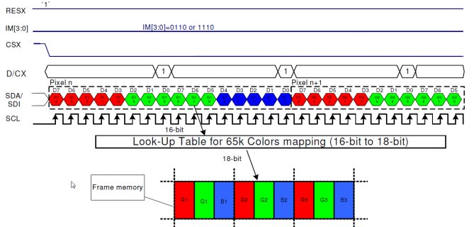

Bugs ?
void ILI9341_t3::drawPixel(int16_t x, int16_t y, uint16_t color) {
[I][B]	writecommand_cont(ILI9341_RAMWR); [/B][/I]
	writedata16_last(color);
void ILI9341_t3::drawFastVLine(int16_t x, int16_t y, int16_t h, uint16_t color)
	[I][B]writecommand_cont(ILI9341_RAMWR);[/B][/I]
	while (h-- > 1) {
void ILI9341_t3::drawFastHLine(int16_t x, int16_t y, int16_t w, uint16_t color)
	while (w-- > 1) {
void ILI9341_t3::fillRect(int16_t x, int16_t y, int16_t w, int16_t h, uint16_t color)
	for(y=h; y>0; y--) {
Should'nt this be "writecommand_last(ILI9341_RAMWR);", or is this intended ?
Edit: There are several other places too. I tested this change, it works.
In addition, there is i.e. a line "writecommand_last(ILI9341_NOP);" in drawChar() which can be deleted. Several other "ILI9341_NOP" too.
Question: Could the original-version cause problems with other SPI-Devices ?

I am pretty sure it is intended. You want to hold cs asserted until you output your last byte of the last pixel you are writing out...
No this is for commands only. They are sent before the pixels.
In the meantime i edited the whole lib(still works) and took a look at the datasheet. The datasheet says cs for cmd should be 1 for the first bit of pixeldata.
So it might was intended but not correct !
Give it a try :)
Ill do a pullrequest later this day.
Datasheet (please noice the "1" for command-cs):
preliminary updated lib (please test !) :
View attachment ILI9341_t3.zip
- it's a tiny little bit faster too, because of the deleted "NOP"s

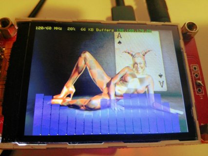

This little T3.1 is unbelievable fast...
Alphablending 18-Bar 25Hz FFT256 Spectrum of software-decoded 128kBps WLAN webradio-MP3 Stream (2MBaud UART / ESP8266), 128KB SPI-RAM@20Mhz(more needed for more reliability, I will attach more soon), ILI9341@30MHz, IR-Remote-Receiver (via Timercapture-Interrupt), 20% processorusage (note, this is not the "audioprocessorusage", it's the average overall usage measured over 300ms intervals )
Watch Video
..but I'm running out of flashmemory now :-(
I have parts of the background-picture (only the background of the bars) in the program flash.
Even if it's just the background of the bars : It takes about 50KB (2 Bytes per pixel)
Additionally, there are some more areas, it's not visible in the photo because it is not finished yet. The flash memory is running out... Perhaps i could use SPI-Flash, but this would take additional time for the transfers.
