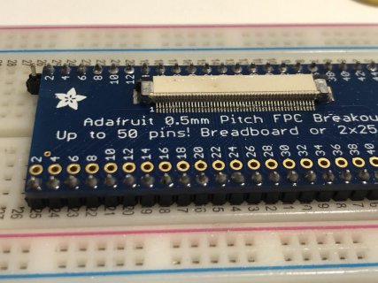

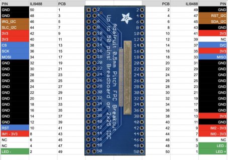

I'm ordering the 3.5" ILI9488 display from buydisplay.com
I'll connect it to an FPC breakout board for testing. I know there are some additional components required such as the driver transistor for the backlight, but I see other components on the 3.2 adapter you built in 2017 and would be interested in seeing a schematic if possible

what I suspect are micro solder shorts on the FPC connector.
