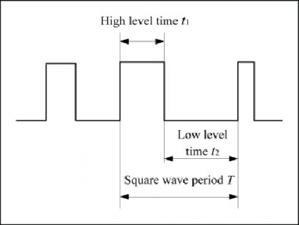

Would it be possible to read each pulse of the encoder (rising edge falling edge) and get the DeltaTime between each consecutive pulse? And printing these to the serial(or SD card) using a circular buffer to get all pulses printed?
Ex: (using image attached).
One pulse print:
Pulse1:
High Level (t1) for “X” time.
Low level (t2) for “Y” time.
And so on.
Or if it starts from a falling edge start reading the Low edge(t2) and then the next high edge (t1) and print same as before.
In the CNC community this is called “record the output of a manual pulse generator MPG” if this helps.
thanks for the support.

Given that the encoder is 800ppr and max capable readings is at 5000RPM the max frequency should be 66.67Khz
MaxFrequecy= (800pprx5000rpm)\60
It's unnecessary to design for that high frequency/high RPM because your stepper motor will not be able to run that fast. From my experience a NEMA17 stepper will do 10-15 revs per second at best [5000 RPM is ~ 83 RPS].
By the way, you may want to scrutinize the datasheet of your 800ppr encoder because the electrical max output frequency is usually well below the mechanical max revolutions.
That said, I think it's wise to take a small step back and first get some experimental data on what number of clicks we are actually talking about in your physical application.
