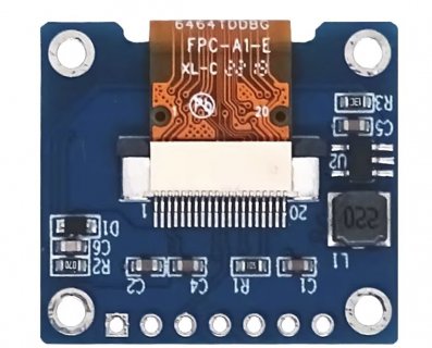

Hi everyone,
I'm doing a project where I want to use a very tiny OLED screen, just 0.6", that is also full color. The screen comes as a bare screen, or with a module.
It would be trivial to hook it up using the module, but the problem is space is at a premium. I don't understand why these companies make tiny screens and then the PCB module doubles the size of it all. I need a PCB to be same size as the screen, or slightly larger.
So I'm posting here becauseI don't know how to design it for this screen. I've designed PCBs, and I have the pinouts of the FPC connector from the manufacturer, but I'm not sure how to correlate them with output for the Teensy 4.x.
Also one more point - the module the manufacturer makes has all sorts of resistors, a big capacitor (looks like), I think a voltage regulator - all stuff I could add, but I don't know what goes where.
I'm wondering if anyone can help me figure this out.

And the rear of the unit with all the resistors and regulator etc:
Is this a huge ask for help in figuring out how to reverse engineer the module so I can make my own PCB? The module they make is just too huge and won't fit the project, and I dearly want to use this screen. I even found a great library for it, a port of the famous Bodmer TFT eSPI, which is thrilling because it's such a great library.
I mean worst case I could buy the module and beep it out, but I've never done that before and I'm concerned I might miss something important or accidentally screw it up. I believe they add all those components for a reason.

Looking at the components around U2, there is an inductor (L1) there which suggest it is a power supply of some sort. Most probably a boost converter.
Have a look at this board, it has a similar power supply:

Your schematic like that is not going to work. If you look at the OLED module there is U2 and L1. You haven't got there on your schematic.
On the OLED panel pin 2 is VCC. Look at datasheet section 4.3 page 10. VCC requires a voltage of 12v. You are connecting it to 3.3v
Have a look at the Adafruit's schematic and see what value they used for resistor for IREF and the capacitor value.

Looking at the picture it is almost possible to see the tracks.
I would suggest that you buy the display with the mounted control circuit and try to figure out the circuit from there,
It will also give you a completed part to compare with yours when you program it.
I would get the Chinese one working(programmed) first then move onto yours.

Thank you @skpang. I saw that 12V and was confused because this screen can be powered from 3.3V. So I assume there must be some voltage tripling circuit. In the tentative schematic I only included what was in the data sheet, which obvs is missing vital info.
Much appreciated.

I have also asked a couple companies that make this screen to see if I can get a schematic from them for an external module, since they already make one, albeit too large - that would be the ideal situation. I'll keep this thread updated with what I find out, and how it progresses. Maybe some of you would like to use a screen like this with a smaller footprint, so when I figure it out I'll make the schematic available. But it might take me a bit to figure this out.
