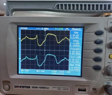

I have also tried checking the signal via an Oscilloscope , however, this is the signal I am getting which isnt correct , despite the communication being successful ( I added another debug to show error in messages in case I removed the CANH/CANL wires from one transceiver )

Thanks for your pictures. That CANL/CANH(?) signal indeed does not look well.
What happens if you lower the baudrates on both sides to e.g. 125000?

Hello Paul, no worries mate! I have managed to make the motor work with my teensy 4.0 and SN65hvd230! I realized that if I called both CAN0 and CAN1 in my code and didnt common the ground of my power supply with the transceiver, the signal became a proper square wave just like CAN is supposed to be, omitted the mcp2551 and then used the exact code on my motor with these changes and it started working!
However, Im still not sure why do I need to call both can0 and can1 even if Im only using a single controller out of these? ( I tried omitting either one but the motor instantly became unresponsive)
This is very strange... When you only use 1 CAN interface of the Teensy to talk to your BLDC motor, you shouldn't need to call another CAN interface on the Teensy to get the first one working.
What do you exactly mean by "didnt common the ground of my power supply with the transceiver"? Can you show us a photo on how your setup/wiring is with the motor attached?
