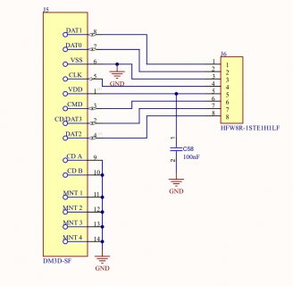

I am trying to read/write to a sd card connected to the teensy using the bottom pads i have no idea how to code that, I cannot find anything online about this, I have the pcb soldered and i pretty sure it works fine i just cannot program it to work. I believe the wiring is correct since a more capable person did it not me lol

I dont have the pcb on me right now but it uses a flat wire connector and connects them like this schematic, i checked the wiring and it is soldered correctly,

Ah, now I can see you're trying to connect a plain SD socket to all 8 SD pins. That definitely does work on the Teensy 4.0 breakout board. It even uses the same socket. Maybe that board's info can help?
On the software side, any of the SD library examples should work if you simply edit the chip select to BUILTIN_SDCARD.
If it's still not working, best I can tell you is this really does work when you make that simple edit to the examples and wire all 8 pins correctly. If it's still not working, maybe 1 or more wires aren't connected properly? If you want help double checking your connections, you'll need to show photos. The more clearly we can see your wiring, the better your odds that someone might notice the problem. But without seeing anything, best I can do is confirm this really does work on the breakout board. The same code also works on Teensy 4.1 where the SD socket is wired directly to those 8 pins.

Before the T4.1, I did a few of them. Sometimes without it always working.
One thing I typically do in a case like this is to use a program to check the continuity of each of the pins.
Often times I use a program I have posted several times that @defragster and myself hacked on several years ago.

The idea is you can setup to jumper from either GND or a 3.3v pin to different pins and it will tell which pin or pins that changed state. Pressing enter key on keyboard will swap between trying to set all of the pins to INPUT_PULLUP or INPUT_PULLDOWN and with that which of the pins you should jumper from.
Withe the flex ribbon I had cases where my soldering was not good enough and maybe shorted two pins to each other. Also other times
where the ribbon did not make a good contact...
So if you take a jumper lets say from ground and touch each of the SD Cards data pins, it should how one pin changed state. If none do on a pin, then no continuity. if multiple you have a short... Note: two pins on the connector are GND and 3.3v if you jumper to one of those it will either do nothing or reset the board.
Good luck
TallDog / loglow did a T_4.0 breakout board https://www.tindie.com/products/loglow/teensy-40-breakout-revision-a/ and the SD wires were not right the first time IIRC. Here is a snippet from the product card that might help confirm ordering.
The 'SDCARD' pins are for the socket and there are some crossings from the T_4.0 base pads where a Ribbon cable was soldered and the USB_Host pins were pulled out. This is shown here: https://forum.pjrc.com/index.php?threads/teensy-4-0-breakout-kit.57122/post-211992

Hello Everyone, I got my hands on the pcb and i check the wiring, with a multimeter and it is all good

Any change the Flat Flex Cable is not fully inserted into the connector?
Here is a quick comparison of your image with the breakout board photo. Notice less of the blue part is visible.
Looks like your cable may not be fully plugged into the socket.
cable is fully inserted, trust me i cannot push it any further, the blue part on my cable is just bigger. Also i think the teensy is dead, i dont know how that happened so im on pause till i get a new one :(
