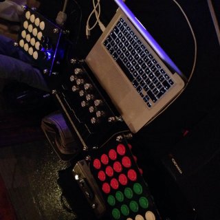

garthtaylor
Hello..
I need desperate help with my controllers
i am using 4 4051s on teensy2 pins A0,A1,A2,A3
how do i code an array to loop through all analog inputs ?
currently i can only read 1 4051 at a time with this code :
Thank you very much in advance !!
