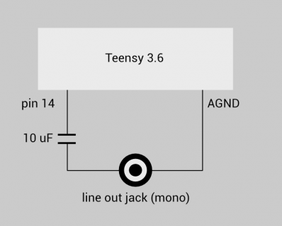

How to get audio output from dac pins on T3.5/3.6?
I found a French YouTube video that shows the DAC and ground going to a powered speaker (with a 10 µF cap between the DAC and the + speaker line in), so I guess I'll try that with this little Sparkfun amp and hope I don't fry something.
This Sparkfun amp has two input pins. Connect the + pin to A14/DAC. Connect the - pin to AGND. It will also work if you connect - signal to GND, but best to use AGND.
This amp has DC blocking capacitors built in, so you don't need to add any extra capacitors on the signal lines. That is needed with some amplifiers, but not this one.
Connect the amp's Power - pin to Teensy GND, and its Power + and S pins together, and connect that pair to Teensy VIN.

1) use INTERNAL
2) It plays the sample once. Just try it first this way, with the sketch as it is. You can change this behaviour later (we will help you).

Hi there... Is there an example of a really basic way to play a wav file from teensy 3.5 built in sd card reader? Sorry, but I'm a total noob at this and the examples at the library use external spi sd card
Look at File > Examples > Audio > WavFilePlayer. The default is using the audio shield, but in the comments you'll find this:
//   3: Analog DAC - Connect the DAC pin to an amplified speaker
//         http://www.pjrc.com/teensy/gui/?info=AudioOutputAnalog
// To configure the output type, first uncomment one of the three
// output objects.  If not using the audio shield, comment out
// the sgtl5000_1 lines in setup(), so it does not wait forever
// trying to configure the SGTL5000 codec chip.
It's really that easy. Just replace the output object which sends to the I2S pins with the one that sends to the analog DAC pin, and delete the unused control object for the audio shield.
The audio library is designed to be extremely flexible. Even though the tutorial shows using the audio shield, if you read the tutorial PDF or watch the video (part 2-1 shows how to use the design tool, and the many parts following show how to do more and more with it), hopefully you'll get the idea that this library has tons of features you can connect together in the design tool. There are several output objects available to be able to send the sound to different types of pins and chips. All you need to do is use this capability. It really does work well.

I came in here with a very similar question.
I'll be joining a Teensy-based project soon. I'm an electronics noob, but I'll be doing the software/DSP development. To already get started I'd like to create a most minimal setup that would allow me to do some testing...
Is the following layout a correct interpretation of the above posts?
