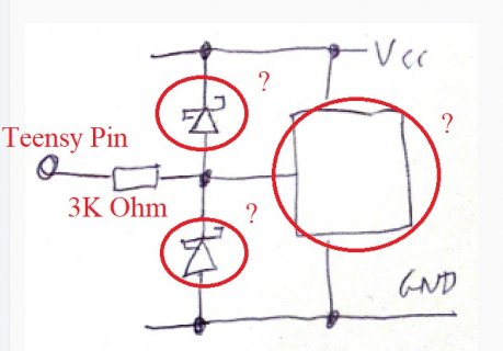

Zeners are not really the answer (they can have pretty soft knees in their response too), the way to do this is with a pair
of Schottky diodes to the rails and a series resistor:
The value of resistor needs to be much less than the internal pull-up, perhaps a few kohms. This circuit protects whether the
circuit is powered up or not, and bolsters the internal protection diodes (Schottky diodes turn on around 0.3V and thus divert
any current before the internal diodes see it (they start conducting significantly from 0.5V or so).
You might want to use a zener or TVS diode to prevent the supply lifting though - ie directly between Vcc and ground
as a crow-bar/clamp.

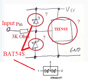

Thank you very much @MarkT, I appreciate it.
If VCC can be up to 24VDC, and let's say I use a 3K Ohm resistor, what specific components do I use for the marked parts?
Thanks again.

Two Schottky diodes and a Teensy (or any CMOS logic chip at all). This is the standard voltage protection - for surface mount people
generally use a dual Schottky in a SOT23 package for this.
You could get away with a zener before the series resistor and skip the Schottky's, but you'd need another resistor to protect the zener
(in other words the internal diodes can be enough with just a resistor to limit current, but only at more modest voltages). 24V is pushing
it really, that can put dozens of mA through the resistor. Often CMOS protection diodes are rated at a few mA at most, sometimes under
1mA. This is why external Schottky's can be so useful, much more current handling.

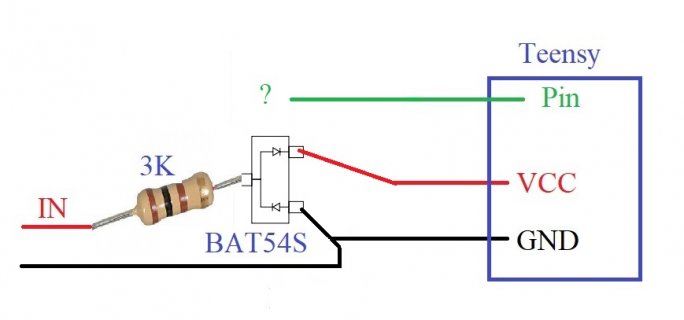

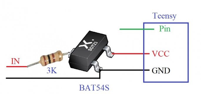

I am still a bit confused :). Please see the attached circuit using the BAT54S. What does the Teensy Pin connect to?
What happens if the "IN" is connected to GND? Will the Teensy Pin be connected to GND?

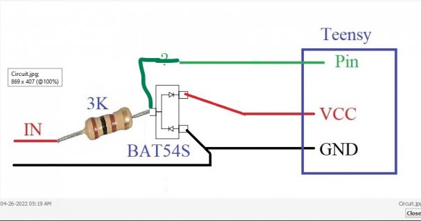

I am just not clear where the green wire in the image below goes?

Thank you @KurtE. I thought so too but wouldn't this connection completely bypass the diode?
That's the point - the signal "bypasses" the diodes unless the input voltage strays out of range, in which case one of the diodes
conducts and clamps the voltage.

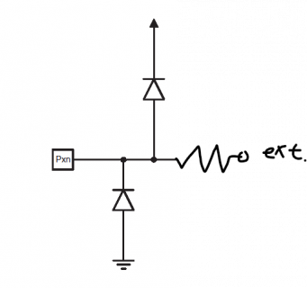

I found this schematic diagram from an AVR microcontroller. It may be easier to understand since the diodes are drawn almost in line. You can imagine the resistor on the right to external input and Teensy pin on left.
So if you have 3.3V/GND on Teensy, and say the diodes have 0.3V of drop when conducting forwards, then your pin is protected between -0.3V and 3.6V. I bet that makes the pin happy.

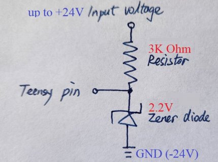

I am just trying to protect from the possibility of the Teensy being destroyed if a pin accidentally is connected to 24V.

Thanks to all. I received the parts.
I tried first with a BAT54S Shottky but I was never able to solder them as they are so tiny!
So I tried with the attached circuit using a Zener diode. Up to 24V, the Teensy pin only got about 2V which means it is protected.
However, my main question is that in my application, I want to detect when the Teensy pin is connected to GND (Teensy getting a dry contact ...). I needed pin protection in case somebody applies a large voltage (> 3.3V) to the Teensy pin.
So while the attached circuit works when a large voltage is applied, it does not work if the input is shorted to GND ....
