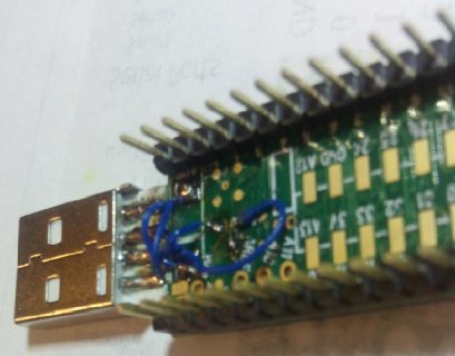

These little USB Micro connectors work great if you pull the cable straight in and out, but bending the cable upward with the board firmly attached to a surface can break the little connector off the board. Usually some of the metal pads will tear off the board, so you can't just solder a new connector in place.

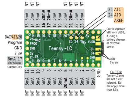

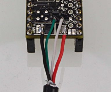

If this happens, here's a way to recover by soldering a cable to the board. All 4 wires can solder to pads on the bottom side.
(click to enlarge)
The USB spec actually requires these 4 wire colors, with this assignment to the signals:
pin 1, +5V, Red
pin 2, D-, White
pin 3, D+, Green
pin 4, GND, Black
Most USB cables should follow this color scheme, since it's required by the USB standard. If in doubt, you can check with an ohm meter from the wires to the connector on the other end of the cable.
