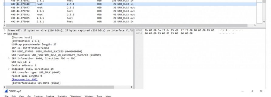

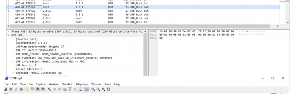

So below what I get. I do think the problem is the initialisation of the device after the first handshake. It accepts few bytes, but after go to sleep. At the end it is trying to write data to 70x320 section of display so quite lot of data.
How should I write big amount of data, 16200 bytes in this case. Now it is just write a byte at the time.

Can I write 512 or 1024 at one write?
I assume this is no response from the device? This continues for ever (or maybe the 16200 bytes) They come at fast rate difficult to say, but maybe several 100 per second.
What does the TX:moar data!!!! mean, and what is the tx2.

Is this something to worry about. Is it missing some service the device would like to have?
