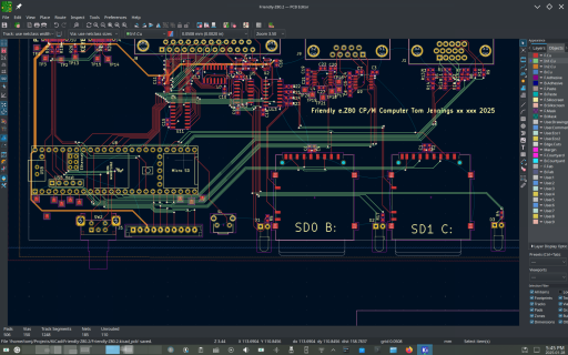

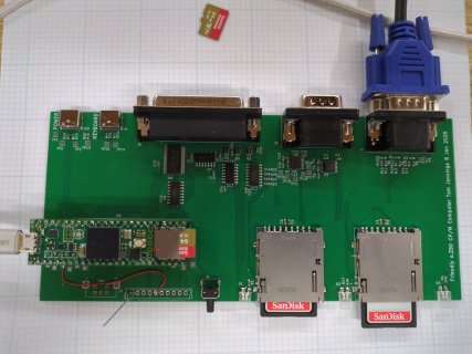

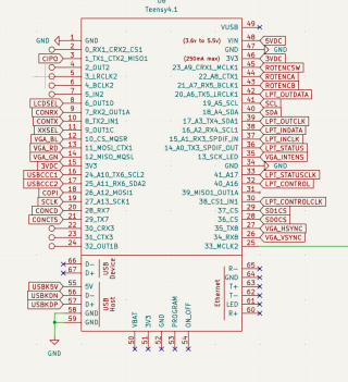

Well its a PCB, here's the deets. I agree, it should be working. I suspect I'm having an SD-code-not-SPI problem.
Oh, I know SPI1 is being used -- before this I could see the SPI signals on the SPI (default) pins. THey've moved to 1, 26, 27 as expected.

Hey, thanks UhClem. Lol the error code is SD_CARD_ERROR_CMD0. "0" sounds early... But I'll now go look that up and start to debug the SD library I think I found.
SDClass has no such member, but SdFs does.
EDIT: OMFG of course it was a stupid and basic misteak -- wrong MISO pin. I misread traces on my own PCB. Sheesh. Error 0 is as expected the initial test select fo the SD card, so an SPI issue. I'd seen the brief response from the card to Teensy on the pin, but the wrong pin. Off-by-one error.
