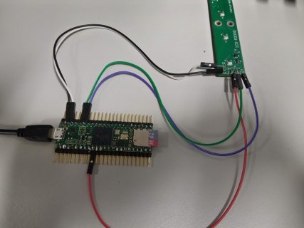

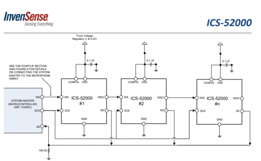

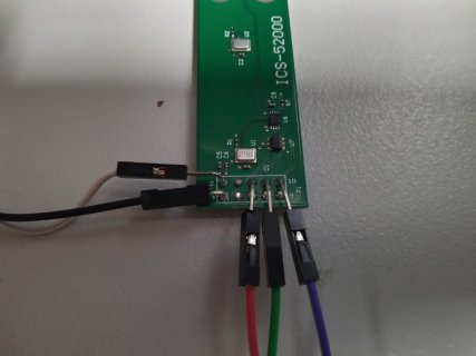

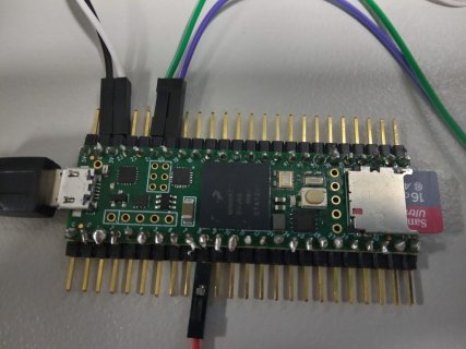

We are connecting the ics52000 microphone array with teensy 4.1, and we wish to send the microphone
signal to the pc through usb audio.
Here are the pin connection, note that I have shield the pin 1 3 5 7 9 together at the other side of the microphone array board.
and the code used

I have change the port to be "audio" and manully upload the code to teensy.
I am using the https://friture.org/ to inspect the signal,
but I can not see any signal at all.
I do have used the the audio shield and send the signal to the pc as usb audio, and it
works.
I do not understand why it does not work with the ICS52000 TDM microphone.

In how far you have to modify the I2S setup must be checked (BCLK, FSYNC)
But first, note that I2S uses also for TDM
	CORE_PIN4_CONFIG  = 2;  //2:TX_BCLK
	CORE_PIN3_CONFIG  = 2;  //2:TX_SYNC
and not the RX_BCLK and RX_SYNC you have choosen

where I included a local implementation of the TDM code for both T3.x and T4.x to allow flexible 16-bit extraction from 32 bit words
As said,
ICS 43434 is working
ICS 52000 (4 channel) is not working
by not working I mean that 4 channels are send to teensy but the two channels send to PC are only noise (no acoustic signals)
We are the audio and acoustic group at a unverisity, we need a largr number of microphone for recording a noise source in all directions.

I do not know what should I do with them
Can you help us get the ICS52000 four microphone array working with Teensy 3.6.
Someone from the forum has successfully got the four microphone array working with Teensy 3.6.
We have tried their code and did not get any success. :(

no, the sgtl5000 is for the pjrc audio board
re ICS52000 see https://forum.pjrc.com/threads/4856...TDM-evaluation?p=218184&viewfull=1#post218184
it seems that it is the NotWired.co board that is not working-
if you build a board following the original design, maybe the ICS52000 is working
maybe you can confirm that there are no other parts than the one shown in this picture
Yes, I confirm that, there are no other parts than the one shown in this picture.
I think maybe it is the 100k resistor 's problems !!
In the pcb of the 4 ICS52000 microphone array, they do not have the resistor.
Thus we use the array, we may have to put a 100k resistor there. :D
We tried to connect our own ics52000 PCB with the Teensy 4.1.
But no luck, it is still not working. :confused:
I think maybe it is the ICS52000 microphone's problem.
