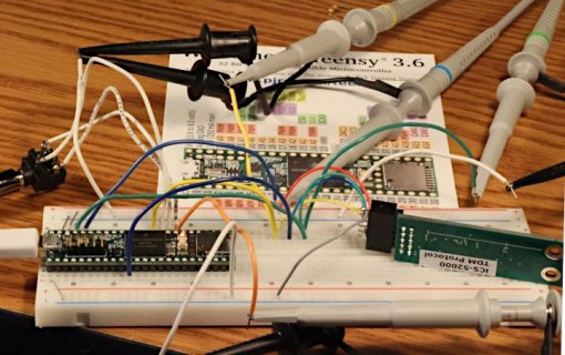

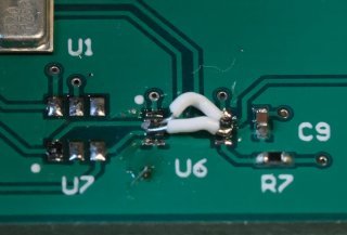

I made another attempt to test ICS-52000 with the notwired.co board with Teensy 3.6.
In every test I tried, all 4 microphones appear to be transmitting only a worthless static. It seems to never respond to actual sound, even directly touching the PCB right at the bottom side holes where the microphones supposedly "hear".
I even tried an experiment to extract the 32 bits and apply digital gain to hear some the low bits which are received by TDM channel 1.
I don't know why the ICS-52000 mics are transmitting worthless noise and don't seem to hear any real sound.
