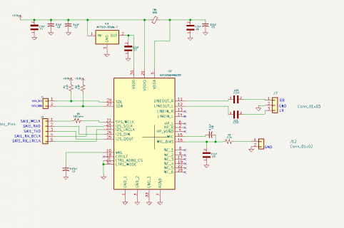

I have designed a custom PCB using the MIMXRT1064 processor and the SGTL5000 audio codec.
For the SGTL5000 circuit, I followed the standard/reference SGTL5000 schematic.
The connections between the RT1064 and SGTL5000 are as follows:
  • LPI2C1_SCL → GPIO_AD_B1_00
  • LPI2C1_SDA → GPIO_AD_B1_01
  • SAI1_MCLK → GPIO_AD_B1_09
  • SAI1_RXD → GPIO_AD_B1_12
  • SAI1_TXD → GPIO_AD_B1_13
  • SAI1_RX_BCLK → GPIO_AD_B1_11
  • SAI1_RX_LRCLK → GPIO_AD_B1_10
I have attached the relevant part of my schematic as well.
My main problem is that after flashing the firmware, I am not receiving any I2C ACK from the SGTL5000.

Check MCLK output.
SGTL5000 remains in a low power reset state where it's unresponsive to I2C if no MCLK signal is seen.
If that doesn't solve your problem, perhaps get a Teensy 4.1 board and audio shield (known good hardware) to test your program.

Why is it working in the slow bit-bang test but not with LPI2C?
Whereas from your code output (the code itself would be helpful…), you appear to have set the I2C to run at 10MHz, which isn’t viable for any parts I’m aware of.
Thanks for the reply. To clarify: 10 MHz is the LPI2C peripheral's functional clock inside the i.MX RT1064, not the SCL frequency. The bus is configured with baudRate_Hz = 100000, so SCL runs at 100 kHz, well below the 400 kHz limit.
Current status: with a slow bit-bang I2C (~1 kHz) the SGTL5000 ACKs at 0x0A, but CHIP_ID reads back as 0xBFFF instead of 0xA011. With LPI2C at 100 kHz every address NAKs. SCL/SDA have 2.2k pull-ups to 3.3 V, and MCLK is 12.288 MHz. The same codec board works with a Teensy 4. Any ideas?
You haven't shown any code at all, nor posted any confirmation of it working on a regular Teensy.
This is the code i am using in teensy with my custom board codec
and i am getting 0x0A correctlly

Update: MCLK testing results
The RT1064 board and the codec board are two separate boards, connected with jumper wires. I tested the codec using MCLK from two different sources, with the same RT1064 I2C firmware.
Test 1: MCLK from the RT1064 (SAI1_MCLK, GPIO_AD_B1_09, 12.288 MHz)
  • A DC multimeter on the MCLK pin reads about 1.57 V (supply about 3.1 V).
  • Slow bit-bang I2C (~1 kHz): the codec ACKs, but CHIP_ID reads 0xBFFF / 0xA01F instead of 0xA011.
  • LPI2C at 5, 10, 20, 50 and 100 kHz: NAK at every speed (status 902).
  • With a weak MCLK pad setting (0x1008), the codec doesn't answer at all and the MCLK pin reads about 0 V.
  • Different MCLK pad drive settings made no difference.
Test 2: MCLK from a Teensy 4 (pin 23)
  • RT1064 MCLK jumper wire disconnected from the codec board.
  • Teensy MCLK connected to the codec board's MCLK pad , Teensy GND connected to the codec board's GND.
  • RT1064 still drives I2C (SCL/SDA) through jumper wires.
  • RT1064 LPI2C at 100 kHz: CHIP_ID = 0xA011 and CODEC_Init OK.
  • A DC multimeter on the Teensy MCLK reads about 1.7 V (3.3 V supply).
Conclusion so far
The codec board, its power supplies, the I2C wiring and the I2C firmware all work. The problem is only the MCLK coming from the RT1064 board. The DC level looks normal on a multimeter, but the codec behaves as if the 12.288 MHz clock arriving from the RT1064 is not usable.
MCLK (~12 Mhz+ fast edges) via jumper wires is often unreliable. It should be kept as short as possible. If that doesn’t help, try adding a resistor (range 47–68 ohms) in series. Can you take a photo?
I already have a 100 Ω series resistor on the MCLK line. You can see it in the codec schematic that I posted in the previous chats.
When I tested my codec custom board with a Teensy, all the connections were made using jumper wires, and the codec worked correctly.
In another test, I connected only the I2C pins of the codec board to my RT1064 custom PCB, while the MCLK was supplied from the Teensy through a jumper wire. In this case also, the codec initialized and worked correctly.
However, when I soldered the codec custom PCB directly to the RT1064 custom PCB, the codec stopped working and I was unable to initialize it.
This makes me suspect that the problem may be related to the MCLK generated by the RT1064. The RT1064 may not be generating a proper clock signal for the codec. I am measuring approximately 1.57 V on the MCLK pin with a multimeter.
Currently, there is already a 100 Ω series resistor on the MCLK line.
Should I add another 47–68 Ω resistor in series with the existing 100 Ω resistor, or would that make the total series resistance too high?
Or is it more likely that there is a configuration issue in my RT1064 program, such as the MCLK clock source, PLL configuration, clock divider, pin mux, or SAI configuration?
Make sure there is indeed a solid connection between the MCU's pin and the 100R resistor.
1.57V measured with the multimeter is an averaged value, since it cannot measure such high frequencies.
Maybe the solder ball is flaky for that pin and the clock signal gets distorted, confusing the codec. The DC voltage measurement will not show it.
If you don't have a scope or one of those cheap logic analyzers, write a simple sketch setting the MCLk pin to OUTPUT_OPENDRAIN, add an external 10k pull up and toggle the pin each few hundred ms. Observe the multimeter and watch for any missed level changes.
If your multimeter has a duty cycle mode (%) you could also output a lower frequency PWM (ie 10kHz, depends on the multuimeter specs) on the MCLK pin, sweep the PWM duty in steps and look for any weird unstable readings. Blow some hot air on the MCU to see if the thermal expansion is causing any issues.
I guess you could also try to use a PWM audio output on the MCLK pin, add a sinewave generator, run the signal through a RC filter and record it on the PC into Audacity or any other audio editor. Any unregular distortion, glitches would indicate there is something wrong with the path between the MCLK pin and the outside world.
A scope would be ideal, but if there is none, there are other indirect test methods.
