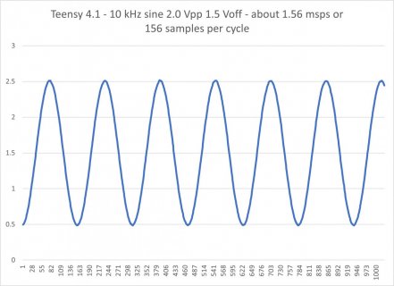

I am working on an improved RingBuf ISR example for SdFat. I want to handle the cache for DMAMEM correctly and achieve the maximum ADC rate.
This is an example to test at maximum speed so I am not concerned with accuracy.
It appears that arm_dcache_delete() is only required on Teensy 4.x and only for RAM2. Please look at the example code and see if my use of arm_dcache_delete() in the ISR is correct.
Also look at the ADC setup and see if it gives maximum ADC sample rate.
The example runs at about 1.56 msps or 3.125 MB/sec on Teensy 4.1 and 1.36 msps or 2.727 MB/sec on Teensy 3.6.
I have modified the SdFat RingBuf class to work in an ISR or in a multi-thread system like ESP32.
I have attached the example with a modified version RingBuf.h. It should work with the current version of SdFat.

Here is a chart of Teensy 4.1 data:

Hi Bill,
Will try to look through it more soon.
arm_dcache_delete - is potentially needed anywhere that the hardware cache is used. It is not used on DTCM. As you mentioned it is needed for RAM2, and also
if you are using a Teensy 4.1 that uses external memory (optional chips soldered onto the bottom of the T4.1)
An interesting thing about the arm_dcache_delete and the other arm_dcache... commands is it works on blocks of 32 bytes of memory. So the call to this may impact memory before and after the block you passed in.
Which can cause interesting issues, as this call deletes the stuff from the cache without first writing the contents out Which cause some subtle issues.
like suppose you malloc 16 bytes, and then use this call to clear out a cache. That call might cause the heap data structures to be corrupted if, they end up residing in the range of
memory that the delete call hits.
Which is why sometimes I simply call arm_dcache_flush_delete instead as it will flush everything first... FrankB also had a Safe version of the delete that checks if the first block and/or last block are partial blocks and does a flush on those sections.
