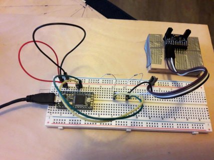

I received my Teensy 3.2 the other day and haven't done anything other than 'Hello world' on it so apologies if I've missed something really obvious. I'm trying to connect it with an mpu9250 imu. This MPU9250 works well with an Arduino Uno. When I scan the mpu9250 with a I2C scanning code on the Arduino, it shows up as 0x68 (the accelerometers/gyros) and 0x0C (the magnetometers).
When I scan the mpu9250 using basic_scanner.ino (found here https://github.com/nox771/i2c_t3/blob/master/examples/basic_scanner/basic_scanner.ino), nothing happens, it doesn't even get as far as Serial.print("---------------------------------------------------\n");
Scanning using this
It prints:
It finds the accelerometers/gyros but not the magnetometers.
When I try to run https://github.com/nox771/i2c_t3/blob/master/examples/basic_scanner/basic_scanner.ino it prints:
I run a similar code on the Arduino Uno and that code works:
I have tried with and without 4.7kohm pull up resistors. I use the Arduino IDE with the Teensy loader on Windows 10.
Here is a photo of the wiring:
I'd be very grateful for any pointers on what I could be doing wrong.
Scanning using this

It prints:
Scanning...
I2C device found at address 0x68 !
done
MPU9250 I AM FF I should be 71
Could not connect to MPU9250: 0xFF

if (c == 0x73) // WHO_AM_I should always be 0x71////CHANGED 71 TO 73
