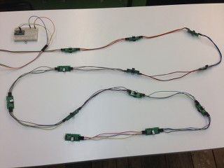

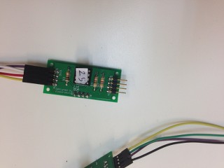

Here there are
Close up of a board
and a pic of the entire chain connected to teensy 3.1
In the pic you don't see the ultrasonic sensors I'm using : http://wooo.altervista.org/wp-content/uploads/2013/09/hc-sr04.jpg (one on each board)
and the 5 volt powersupply (Dc/Dc converter) : http://www.mini-box.com/DCDC-USB
As you see each board is connected to the next using 4 30 cm jumpers. They carry both power and signal.
I measured the voltage at the end of the chain and its still 5 volt.
The chain is approxximately 5 meter long.
Does running my edit of your sketch report failed read with the furthest members of the I2C bus the most?
There's the culprit! I say that with such confidence because with the first prototype for my LED lighting system (TippyLighting ling in my signature) I had the same issue. I had connected 5 LED driver boards per I2C with generic cable to an Arduino Uno over around 4 meters. On each of the LED drivers had 2 I2C devices on board so there were 11 I2C devices on the bus. After running for a while, sometimes 30 min, sometimes several hours, the system came to a halt. It took me a while to investigate the issue.

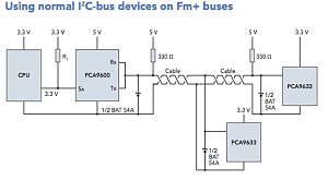

I2C buffer chip
This is the last resort, which I have used for future systems. I am using a I2C buffer chip which allows 30mA/4000pF of bus capacitance. I am using a PCA9600, which allows me to use the Teesny3.x at 1MHz and more of I2C bus frequency even on 5m of Cat5 Ethernet cable. Works like a charm!

Hee i a little schematic of how to extend the I2C bus (Only SCL or SDA shown):
