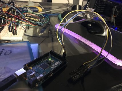

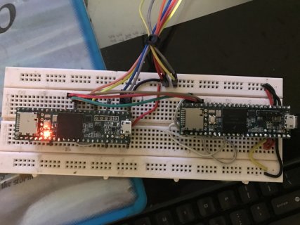

Here is the I2C controller WIP
the gpios, and begin functions run through crc checks to make sure there will be no corruption (if ever) and no, theres been none at all so far (knock on wood)
uarts, and spi busses dont do crc for streaming
im sure there is great potential for this type of code, having extra spi busses and uarts from a spare mcu accessible within the same local sketch, it's alot cheaper to add a teensy than to buy an i2cuart adaptor with flaky library code, with benefits of several integrated hardware features... i plan to extend it with additional features if the need arises, but, just think of the gpio accessibility of it. it's alot easier to control single, or many t3.5/3.6 over i2c with 60 gpios than it is to run 4 mcp23017's to gain 64 gpios, in terms of accessibility, and small footprint, 2 teensies can easily replace an 8 chip bank of mcp23017 port expanders for about 120gpio access using a single host, a single sketch, a small footprint, a single class per teensy slave, with many additional hardware benefits included. Just try to control 8 different types of mcp23017 using adafruit's library, you will see how simple my code here will stand out regarding that:

Also paul, the test with the i2c issue on 3.5 at 120mhz with the i2c bus locking up was tested on latest teensyduino using Faster, constantly read/writing to the uart channel, which never happened on the mega
my initial attempts were to delay some of the transactions but it didnt work, my 2nd test was to drop to 24mhz cpu and thats when it was stable, i presume this is an issue with code being slave needs to be clocked lower, not sure, im not an expert on that.

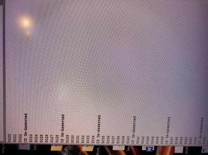

I've also looked around, I dont even think i2c to SPI bus chips exist, but here we have a 2-wire SPI bus.
Benefits?? Sure...
Lets say you have an SPI device and you dont have additional busses for it, or no available gpios for CS, OR, perhaps you plan to install the device further away..... and want to use less wiring back to your host...
this is ideal
