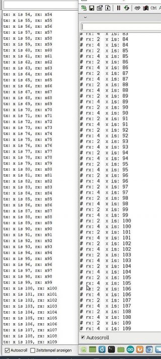

I've got a very simple Master slave setup where the T3.6 would ignore any packets not addressed to it (as it should) and would fire the onRequest callback when a packet is addressed to it.
However after the first addressed message, the T3.6 would then fire the onRequest callback for any packets on the I2C bus regardless of the address used.
This is the code I used on the T3.6. I have tried this on all 4 Wire channels on the T3.6 with the same effect (I have enabled the Wire3 in the library).
Then on the master all I'm doing is the following.
and the console would output
Any ideas why this is happening?
