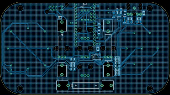

Hello,
I am currently trying to make the I2S audio output of the teensy work with a CS4344
Its data input are:
* SDIN
* SCLK
* LRCK
* MCLK
And while not strictly using the same naming as the teensy, using the datasheet informations I gathered:
* SDIN --> Serial Audio Data Input ie TX (Pin 22)
* LRCK --> Left Right Clock, can be 44.1khz, (Pin 23)
* MCLK --> Master Clock, can be 256x LRCK ie 11.2896MHZ, (Pin 11)
* SCLK --> External Serial Clock Input , can be 32x LRCK, ie 1.41MHZ, is BCLK (Pin 9)
For the rest, I pretty much followed the datasheet implementation.
Still no sound.. Testing with the "Part 1-2: Test Hardware" sketch of the library.
Is there something I am missing?
when using audio library the SCLK is 64xLRCLK, but as fas as I can tell from datasheet only bitclocks of 32,48 or 72 FS are supported
But you can modify the sampling rates easily.

Then it is time to admit something! I have been foolish and directly sent a board to fab without testing the chip first.
Definitely overestimated the plug'n play factor as said before!
You can find the repo here, with source files for the board.
I am afraid I don't have a macro camera that would allow to visually detect issues.
I did test all connections of the chip, and the rest of the circuit works as intended. It gets 3.3v as well.
If there is something wrong it is either:
* In the schematics
* I burned the chip by soldering for too long (It happens, though I was quite carefull)
If you give PDF files for the schematic & layout, I'll take a quick look. But I don't use Eagle, so not going to open your Eagle format files.

I'm confused by the bottom side image.
Is this a transparent view through the top of the board? Or is it actually looking at the bottom side, like holding the real board in your hand?
Sorry, yes this is a transparent view of the board, from the top, with top layer deactivated. It wasn't clear!
Looking at the Teensy footprint, this sure looks like an actual bottom side view, since VIN is on the left and GND is on the right.
But looking at the CS4344, it sure looks like a transparent view through the top of the board, since the pin 1 dot on the CS4344 appears on the right hand side.
Yes, it is because the teensy is soldered on the bottom side. So viewed from the top, we see its belly in transparent view.
Here for a real view from the bottom! Teensy is soldered on this side.
The data connections look ok.
Maybe try measuring DC voltages at all the CS4334 pins? The 3 clocks should measure ~1.65V, since they're 50% duty cycle. If the CS4334 chip has turned on its analog circuitry, you should see DC voltages on VQ and both AOUT signals.
I used to have some CS4344 chips here, but can't find them now, otherwise I'd do a quick breadboard check.
Aha!
As I was testing the voltages, while the prototype was running, I was testing between GND and VCC and suddenly I got sound one one hear!
Plugged it out, then back in, and it was silent once again..
Seems like I inadvertently triggerred something that turned it on.
But at least, nothing is wrong with the library!
It's been a looong day. But thanks to you all, it's working!
The issue was that one of the output was bridged to ground under the chip. This seems to have the effect of shutting the IC.
