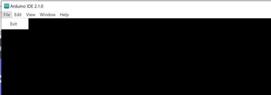

I've been trying different things, including a new download, to get beyond the "File-Exit" problem illustrated in Post #18...no joy. 1.8.19 still works, however. All of this seems very odd to me.

Note: it is not just your tool menu, it looks like all of the menus are screwed up. That is your show: File, Edit, view, window, help menus.
But normally we have:
File, Edit, Sketch, Tools, Hep
If it were me, I would also probably hit it with large hammer. For example as Paul mentioned, delete your current 2.1 install, clean out your Temp folder, at least anything with the name including arduino, and the *.clangd files.

In the case of Linux it says the directory. ~/.config/arduino-ide/
And then I would try to reinstall.
