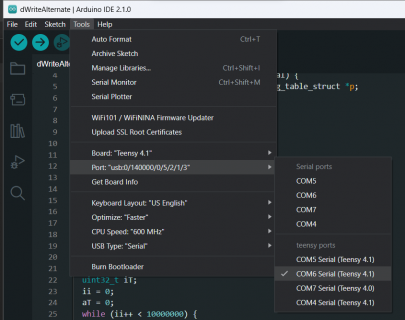

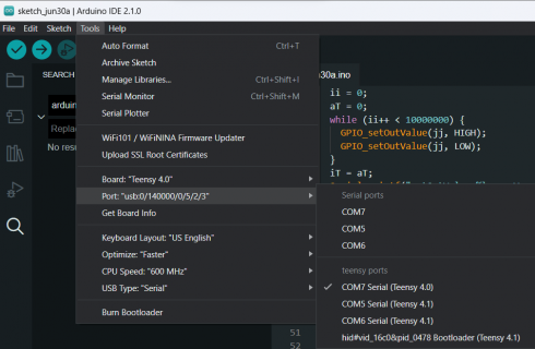

IDE 2 and multiple T_4.1's and a single T_4.0: only sees the T_4.1's
defragster
Senior Member+
Posted this somewhere once and seeing it today on a Just Built Win 11 PC.
Installed IDE 2.1 and TD build 1.58.1 and ran just a T_4.0 for a couple of sketches in remote area in past days.
Today replaced prior desktop with this new machine and plugged in the hub running 3 T_4.1's.
Added a T_4.0 since that was what the IDE was set for - and the T_4.1's were another test.
First uploads took one of the three T_4.1's offline and gave the 'code for 4.0 won't run on a 4.1' error from loader.
Power down T_4.1 with RED LED on and push T_4.0 button and T_4.0 is programmed. If that RED LED T_4.1 was power cycled it would again repeat above with RED LED and loader error on next upload.
Repeat with a removed T_4.1 and IDE 2.1 Upload takes another offline to RED LED and loader error, until there are no T_4.1's powered up.

01:01:45.074 (loader): elf appears to be for Teensy 4.0 (IMXRT1062) (2031616 bytes)
01:01:45.074 (loader): elf binary data matches hex file
01:01:45.074 (loader): elf file is for Teensy 4.0 (IMXRT1062)
01:01:45.074 (loader): Incompatible file, showing warning dialog
01:01:45.083 (reboot 4): Status: 1, 0, 1, 1, 0, 0, T:\TEMP\arduino\sketches\D7731BF0898994AE1C97297FA56C1E86\, sketch_jun30a.ino.hex
01:01:45.083 (reboot 4): status read, retry 3
After writing the above the three T_4.1's were powered up and the same open sketch Uploaded and the failure repeated.
T_Sermon in use for all instances and it was working with the T_4.0 {no other Serial Monitor open or used}
Here is that shorter Loader Verbose:

Moved the T_4.0 to a front USB port to see it wasn't that being on the common HUB and again:
... and fresh Verbose for that - as the T_4.1 has a RED LED and the T_4.0 is running its prior sketch:

Using same sketch changed board to T_4.1. A T_4.1 was selected on Port and Console ended with this:
Memory Usage on Teensy 4.1:
  FLASH: code:36112, data:6092, headers:8992   free for files:8075268
   RAM1: variables:6944, code:33472, padding:32064   free for local variables:451808
   RAM2: variables:12416  free for malloc/new:511872
"C:\\Users\\Tim\\AppData\\Local\\Arduino15\\packages\\teensy\\tools\\teensy-tools\\1.58.0/stdout_redirect" "T:\\TEMP\\arduino\\sketches\\AD3AE4563427576D87162D66EF668B23/dWriteAlternate.ino.sym" "C:\\Users\\Tim\\AppData\\Local\\Arduino15\\packages\\teensy\\tools\\teensy-compile\\11.3.1/arm/bin/arm-none-eabi-objdump" -t -C "T:\\TEMP\\arduino\\sketches\\AD3AE4563427576D87162D66EF668B23/dWriteAlternate.ino.elf"
"C:\\Users\\Tim\\AppData\\Local\\Arduino15\\packages\\teensy\\tools\\teensy-tools\\1.58.0/teensy_size" "T:\\TEMP\\arduino\\sketches\\AD3AE4563427576D87162D66EF668B23/dWriteAlternate.ino.elf"
"C:\\Users\\Tim\\AppData\\Local\\Arduino15\\packages\\teensy\\tools\\teensy-tools\\1.58.0/stdout_redirect" "T:\\TEMP\\arduino\\sketches\\AD3AE4563427576D87162D66EF668B23/dWriteAlternate.ino.lst" "C:\\Users\\Tim\\AppData\\Local\\Arduino15\\packages\\teensy\\tools\\teensy-compile\\11.3.1/arm/bin/arm-none-eabi-objdump" -d -S -C "T:\\TEMP\\arduino\\sketches\\AD3AE4563427576D87162D66EF668B23/dWriteAlternate.ino.elf"
"C:\Users\Tim\AppData\Local\Arduino15\packages\teensy\tools\teensy-tools\1.58.0/teensy_post_compile" "-file=dWriteAlternate.ino" "-path=T:\TEMP\arduino\sketches\AD3AE4563427576D87162D66EF668B23" "-tools=C:\Users\Tim\AppData\Local\Arduino15\packages\teensy\tools\teensy-tools\1.58.0" "-board=TEENSY41" -reboot "-port=usb:0/140000/0/5/2/1/3" "-portlabel={serial.port.label}" "-portprotocol={serial.port.protocol}"
[B]Found 4 Teensy boards, but using auto-search to find board for upload.
Please use Tools > Ports(Teensy) to select the specific board.[/B]
T_Sermon getting output from one of the T_4.1's {Auto Selected when T-4.1 selected in IDE drop Down} and IDE shows:
Same 'Found 4 Teensy boards, ...' message appears after selecting a different Teensy 4.1/Port and build completes.
Verbose shows code was uploaded - but this time T_SerMon is showing the new code output {Verbose was not cleared before - but it seems ONE of the T_4.1's was programmed then too - but not the one shown in the IDE 'Serial Monitor':

As with p#3 it is not the same issue as p#1 and #2 but involves multiple Teensy and loader interaction with console output. Opposite sides of same bad penny.
Turned off two T_4.1's: connected is a T_4.1 and a T_4.0.
Build completes and uploads to running t_SerMon, but this text is shown in the console:
[B]Found 2 Teensy boards, but using auto-search to find board for upload.

Then in IDE 2.1 use TOOLS to set Board and Port to T_4.0 - results in T_4.1 RED LED as in p#1.
IDE console again shows: "Found 2 Teensy boards, but using auto-search to find board for upload. ...
Loader verbose now shows:

Perhaps a clue? Not sure how IDE and teensy serial utils pass list of devices?
Installed IDE 2.1.1. T_4.1 and 4.0 online, 4 sketches open - unchanged from start.
One was: USB-SerialPrint-Speed Test built and uploaded to 4.1 then changed board and port and sent to 4.0 - Both worked. { both running SerMon in separate IDE windows SerMon at 500Klines/sec }
Then opened prior sketch and it gets confused and RED LEDS 4.1 when code for upload to 4.0.
Returned to speed test and it did the same RED LED 4.1 and this worked on start after update restart of IDE.
Question/clue: how does IDE transfer/communicate the device list with PJRC serial code? Seems the list on startup was valid, but doesn't take well to indexing items when changed as far as tracking for above notes?
> Opening a new sketch has unclear interaction and effect on existing open windows
> starting a new sketch 'unsaved' in temp closes and re-opens that window on the new saved location
> once observed: update to board json urls did not take effect in current window - but 'open new' and then board search finds the added URL definitions. Without 'open new' (on windows) this would take a close/restart of the IDE.
--> annecdotal/observed .... but suggests the state of the IDE is both shared and unique across windows/instances - for instance each open windows can now be a unique board, and 'open new' starts with board of that used to open.
<edit>: after first fail repowered 2nd and 3rd T_4.1 and that didn't help - same issue except 'Found 4 Teensy boards' noted instead of '2 boards'

Just to confirm repro - IDE 2 on WIn 11 - Board: T_4.1 and PORT: COM4 T_4.1 selected.
Blink Upload - T_4.0 offline after 'Remove' and same Wrong MCU popup

Move T_4.0 from top hub port to swap with lower T_4.1 and Upload gets the not compiled for this board.
IDE UI Teensy_ports them showed selected port as T_4.1 in bootloader - not T_4.0 where it was last used.
@PaulStoffregen :
Perhaps the problem is that devices coming and going cause IDE 'refresh' and the 'PORT' is unexpectedly changed "behind the scenes"
I did not drop down and check the associated PORT above when it did repro.
But removing and replugging could certainly 'invite' the IDE to change ports to the next available board?
> this 'replugging' was not part of the original Error - and doubtful that @mjs513 did that either when it gave a repro there.
Though Upload taking device to Bootloader then returning may cause unexpected 'background' "port" update?
