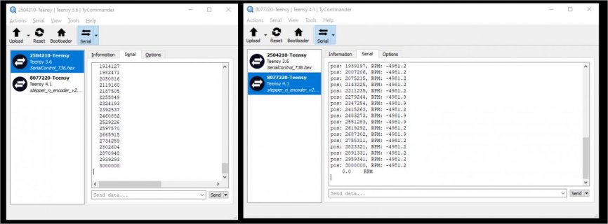

You print the current position in the encoder callback. At high encoder speeds the printing is not yet done when it tries to invoke the callback again. This will basically lock the system.
I moved the printing to loop which fixes it. Here the recording of a 3'000'000 step move with 500kHz count rate. Works perfectly, no counts lost.
(left->EncSim output, right -> output of your code)

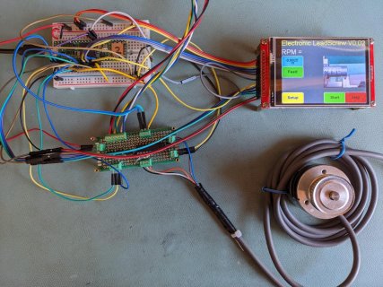

Some more progress on menus and things. All of the threading section is complete. Most of feeds are done. Have lockouts on the stepper driver until explicitly initialized and started. Still need to clean up the state machine to make it easier to navigate between states.

Making some progress - Electronic Lead Screw
An update. Checked out the DRO read head outputs and they appear to be standard 5V TTL levels. This is good, since I can use the spare pins on my 74LVC245 level translator. I am already using three of the pins for the rotary encoder and have five pins left. I need four signals, so this will work. Have to wire in the circuit to the connector blocks. Will do this today.
Wrote some test code with a calibration factor for the DRO, seems to work ok, at least with a rotary encoder as the input. Haven't integrated all three Encoder instances, but that looks straight forward. Plan to add independent units (Metric and Imperial) and clear ability for each axis. Have to design the human interface for that, but it is just 2 or 3 buttons per axis. The DRO display will always be active in the main page. Think the DRO display will replace the picture of my lathe. I am running out of screen real estate! A 320x240 display isn't all that big...

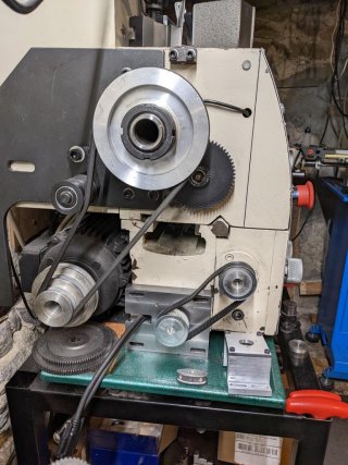

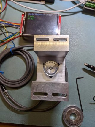

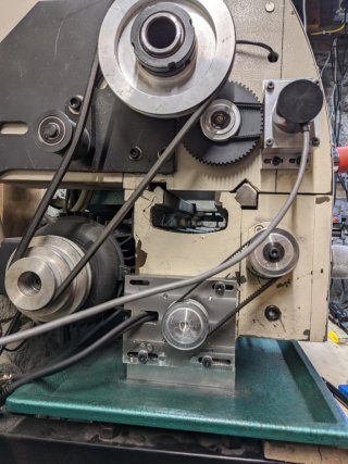

Done a bit of machining. (My other hobby:D) Made a stepper motor bracket that houses the motor inside the lathe ways casting. The NEMA-24 motor just fits! Procured the timing belt pulleys and timing belts. Also fabricated a bracket to hold the rotary encoder. I will need to do some creative work to line up the encoder pulley to the spindle gear assembly. I did not account for the full width of the timing pulley so I need to move something about 2mm. Might have to machine a gear shaft, but it looks like there are several good alternatives to try that may be even simpler. The 60T timing pulley (shown in the chip pan) mounts in place of the small metal gear, on top of the M1.5 60T plastic gear. The 40T timing pulley is attached to the rotary encoder. You can see the encoder bracket on the chip pan. The bracket and encoder mount to the right side of the 60T plastic gear. So far there are no hard problems to fix! Thank goodness for that.
Need to add Reverse and Left Hand threading to the electronic lead screw code. Seems I forgot about that! Should not be difficult to add, but I have to work through the details and make sure there are no hidden issues.

Finally got the stepper motor properly mounted. I had mis-drilled the holes in the lathe casting. Took quite a while to recover from that. Had to make drill bushings and weld them to the mounting plate, then drill through the bushings to make sure the holes went in the right place. Then I had to remove the bushings and machine then flat. Took a while. However, it only took about 10 minutes to get the rotary encoder installed. It's now time to hook up the encoders to the Teensy! First will be the rotary encoder, as that will be easy. Then I need to tap into my DROs and attach them to my level translator. Going to get a lot more fun... First thing to check for is the sense of rotation - clockwise or counter clockwise!
Wired everything up to the Teensy. After some playing around with the stepper driver settings and the gear box, can now cut 10 TPI threads with a 10 TPI setting. Lots more work to do though. Need to reverse the stepper rotation, ahem, got it wrong. It is cutting left hand threads, rather than right hand threads. But the encoder rotation is correct. Very encouraged. I need a filter on the RPM, it is too jittery, with a 10 Hz update. Yeah, and a way to change from left handed and right handed threading. Time on project is about 4 months.
