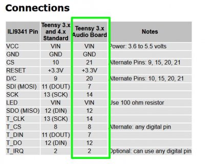

EDIT: SOLVED. The problem was that I had wired SDI(MOSI) to the wrong pin.
Hi, I try to get the ILI9341 working on a new Teensy 3.6 setup here. The touch works (verified by serial terminal outputs) but there is nothing displayed on the ILI9341.
I have an audio board connected and used the wiring in the guide here https://www.pjrc.com/store/display_ili9341_touch.html for when the audio board is connected.
Can someone help me with how to debug this?
Below is the code I run. I know the code runs because there is serial output showing the touch x and y positions.

#include <Arduino.h>
#include <ILI9341_t3.h>
#include <font_Arial.h> // from ILI9341_t3
#define CS_PIN 8
#define TIRQ_PIN 2
// MOSI=11, MISO=12, SCK=13
XPT2046_Touchscreen ts(CS_PIN, TIRQ_PIN);
//XPT2046_Touchscreen ts(CS_PIN); // Param 2 - NULL - No interrupts
//XPT2046_Touchscreen ts(CS_PIN, 255); // Param 2 - 255 - No interrupts
//XPT2046_Touchscreen ts(CS_PIN, TIRQ_PIN); // Param 2 - Touch IRQ Pin - interrupt enabled polling
// For optimized ILI9341_t3 library
#define TFT_DC 20
#define TFT_CS 21
#define TFT_RST 255 // 255 = unused, connect to 3.3V
#define TFT_MOSI 7
#define TFT_SCLK 14
#define TFT_MISO 12
ILI9341_t3 tft = ILI9341_t3(TFT_CS, TFT_DC, TFT_RST, TFT_MOSI, TFT_SCLK, TFT_MISO);
