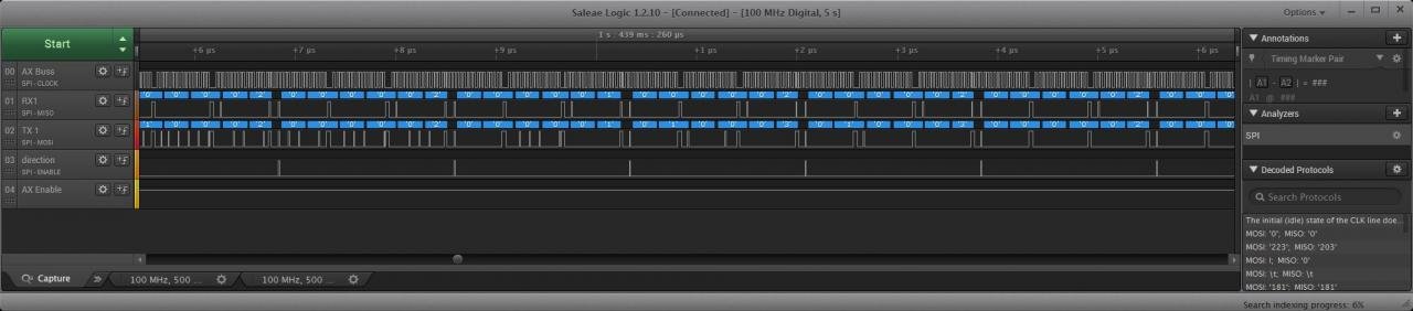

i'm working on a library that provides DMA for the ILI9341. It uses a full screen buffer (size:153600 Bytes).
A first minimal version is already working.
First tests show that full-screen refreshes with >50 Hz (@ 144MHz CPU) are possible, with overclocking the bus.
I plan to adopt some of the functions of the original ILI9341_t3 lib - so here is my Question:
Which functions of ILI9341_t3 do you need, and which are not needed anymore ?
50Hz is fast enough for video - which is the best way to feed the Teensy with videodata ? Which software on PC-side can be used ?

Let me explain how it works..
There are two ways to refresh the display -
a) it refreshes automatically, as fast as possible (up to more than 50 Hz). This way is used in the tests above, because i wanted to use the same test sketch which is used by the original library. Indeed, the code is almost identical (I'll upload it). The same way is used in the "Play video" sketch https://forum.pjrc.com/threads/36751-Teensy-3-6-plays-video-from-SD-Card?p=114615 ("play video" uses this library)
b) you can all a function to refresh it one time (on request, with a) disabled ).
All drawing operations are done in Teensy-RAM, and are not visible until it's contens are copied to the screen (with a) or b) from above).
Usually, it makes no sense to call fillScreen and wait for the result. Instead, you want to fillScreen, and call many other functions afterwards - like write some text draw lines or copy an "icon" to the screen. You want to display it when this "page" is ready to display, not every single step. And exactly this is the point where it makes sense that your tasks get done as fast as possible :) You can wait after all operations are done. Waiting before makes no sense, cause you'll see only a part of the "page".
Then, a benchmarks which measures delays is not really good.. :) and pretty useless. The "Graphicstest"-sketch spends most of the time in delays between the tasks ( well, not on other Arduinos.. ;-) )
No, the textoutput was not ready.... i wrote that in post#2. That was the only "test" which did not work that time. Therfore the "0".
If you want a "delta"..well, use your own test from above, or an other lib and the "graphicstest" sketch.

Hi Frank, that is sort of a hard question to answer. Right now I have it outputting the bytes at 8mhz or 8.33... The UP hardware can go to 25mhz...
BUT! - The user level to system level SPI driver is a killer! Maybe easier to demonstrate by showing a Logic Analyzer output:
As you can see, there is a BIG gap between the output of each call to SPIDEV, the good news is once it gets there, there are no gaps between bytes (unlike Edison), so for the fill screen, I can get the 4K of bytes output pretty fast, which I will put in. Currently doing it as even divide of screen size which takes 40 calls with 3840, but at output of 4096 bytes, can get down to 38...
Also I am having to drive CS/DC using software calls, which adds to these delays as well. But again it is for my own learning, to decide how I wish for UP to talk to Teensy and who does what. More details on my playing with the different things like GPIO, I2C... up on the thread:
